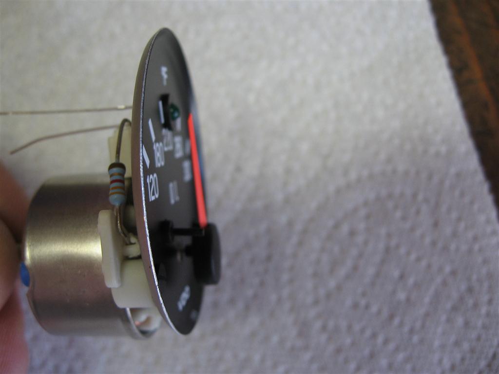

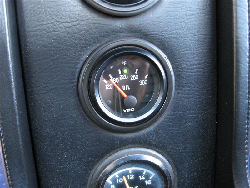

If the EGR indicator is nonfunctional disconnect its wire from the dash and attach your fan wire.
I installed an LED into my oil temp gauge to indicate when my fan is on.

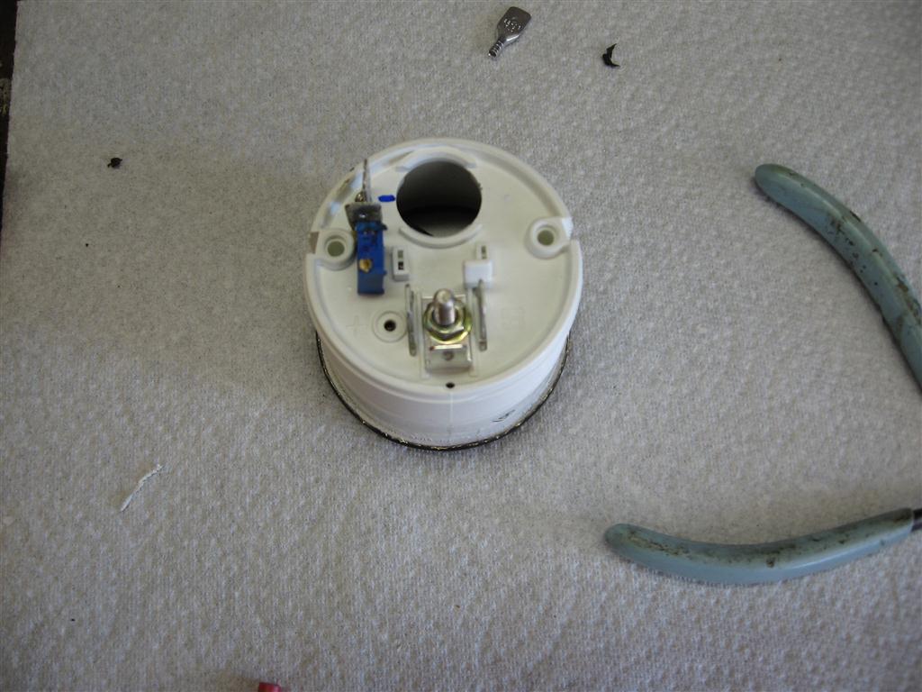

I bought the LED at Frys Electronics. I was sure to get an LED with a bezel. I took the gauge apart and drilled the hole by hand (it came out a little lower than I wanted). The needle clears the LED. I used a variable resistor on the LED to control the brightness .
