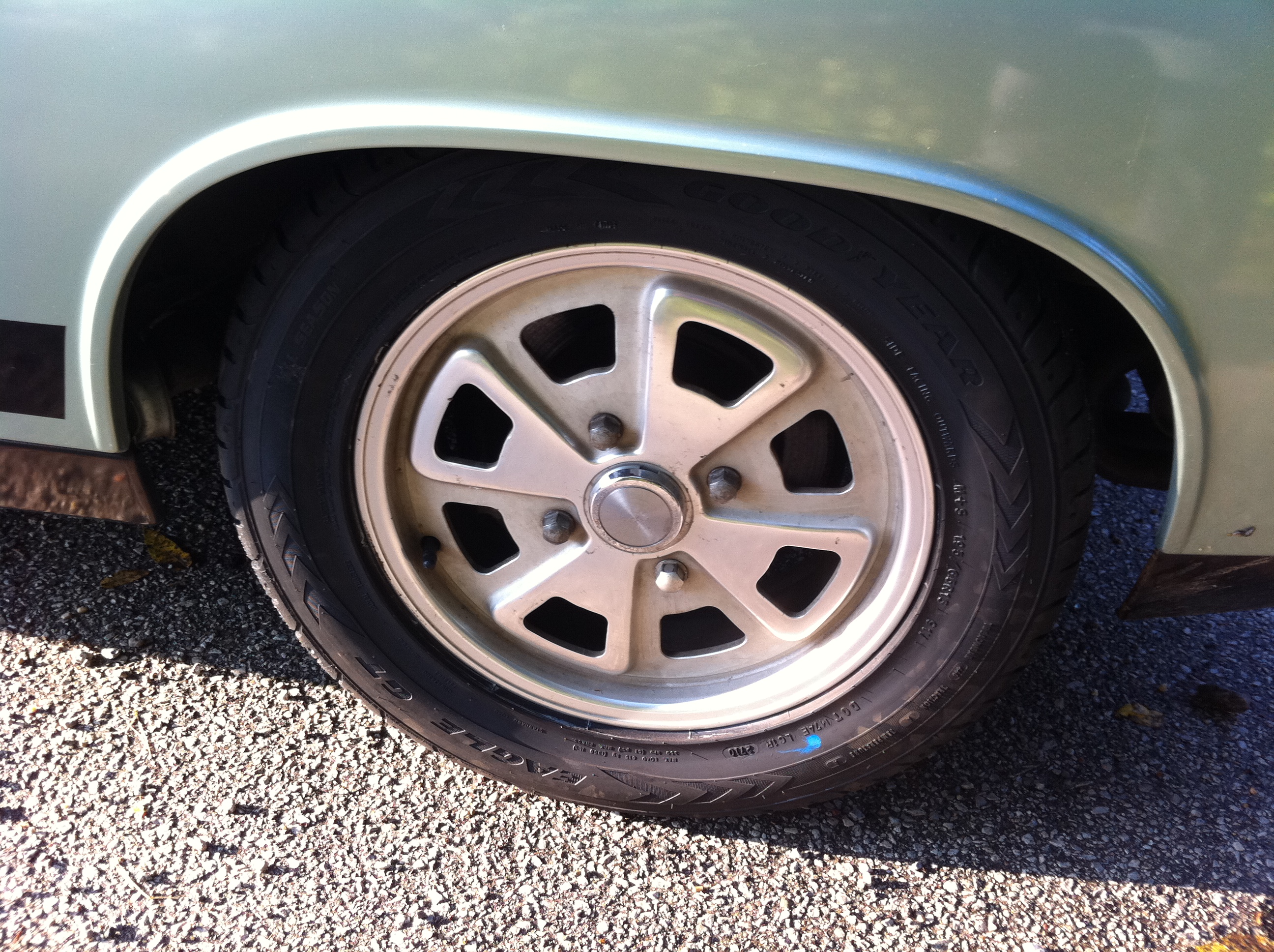

Shoe, I have 195/65 Eagle GT's on mine and like them.
Rear:
