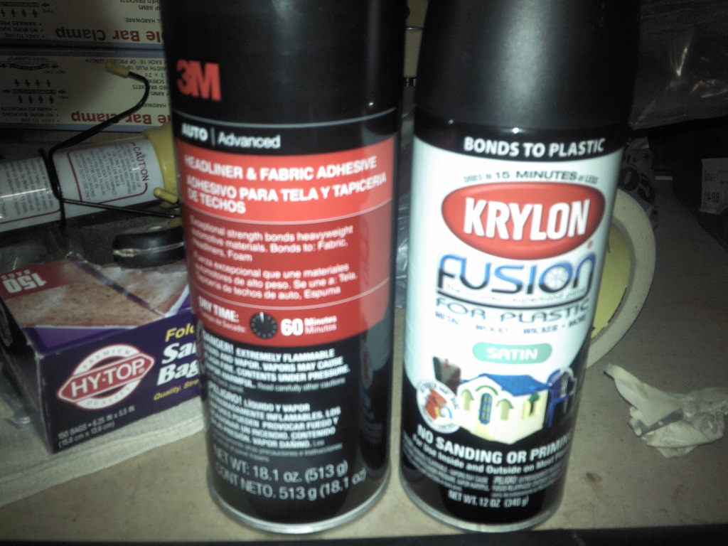

Looks Great! What supplies did you use? Felt? Paint? Glue? How did you prep the top for paint? Thanks!

I bought a pre-made headliner from 914Rubber.com (as well as all the rubber seals), and the paint and headliner adhesive I used in the picture below. For the underside of the roof, where all the old glue was, I used an orbital sander with 150 grit, to remove that. for the rest of the roof, I used a medium scotch brite pad (green pad), and lightly went over the whole roof. After I vacuumed the dust off, I used a cotton rag with a little paint thinner on it to clean the remaining residue of the top. After that dried completely I painted it.
