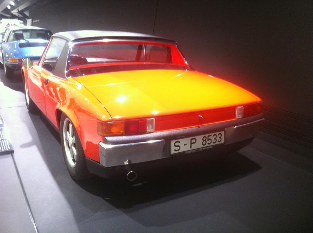

Thanks! And WOW what a great follow up to this! Great content you provided! (IMG:style_emoticons/default/beerchug.gif)
I never saw the badge on the orange 914 from the museum (have seen it there, just not the front of the car). I presume that's the other 914/8 made for the museum since it has the prototype front bumper. I've never seen a badge that low! Maybe because it's a prototype. I don't care for it there. I do like it nicely placed even with the headlights, mid-height (halfway up). Gives a nice, even symmetrical look.
