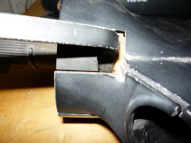

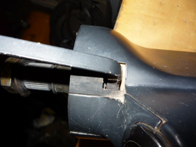

914Sixer
post Dec 10 2012, 08:18 PM
Posts: 9,186
Joined: 17-January 05
From: San Angelo Texas
Member No.: 3,457
Okay, here are the pictures. I just happened to have some columns out. You simply cut the plastic bottom tab off on the switch.

From: San Ramon CA
Member No.: 104
Thanks Mark, It looks like the steering column cover is notched, not the switch. Please correct me if I am wrong.

914Sixer
post Dec 11 2012, 08:24 PM
Posts: 9,186
Member No.: 3,457
Jeff,
The picture is a little off. The angle of cover for the ignition switch is in the corner. You just cut the bottom of the plastic tab on the wiper switch. 1st picture show switch with not cut off. You can take a knife and cut tab off with column in car, or you can cut it off smooth be for installing switch.
