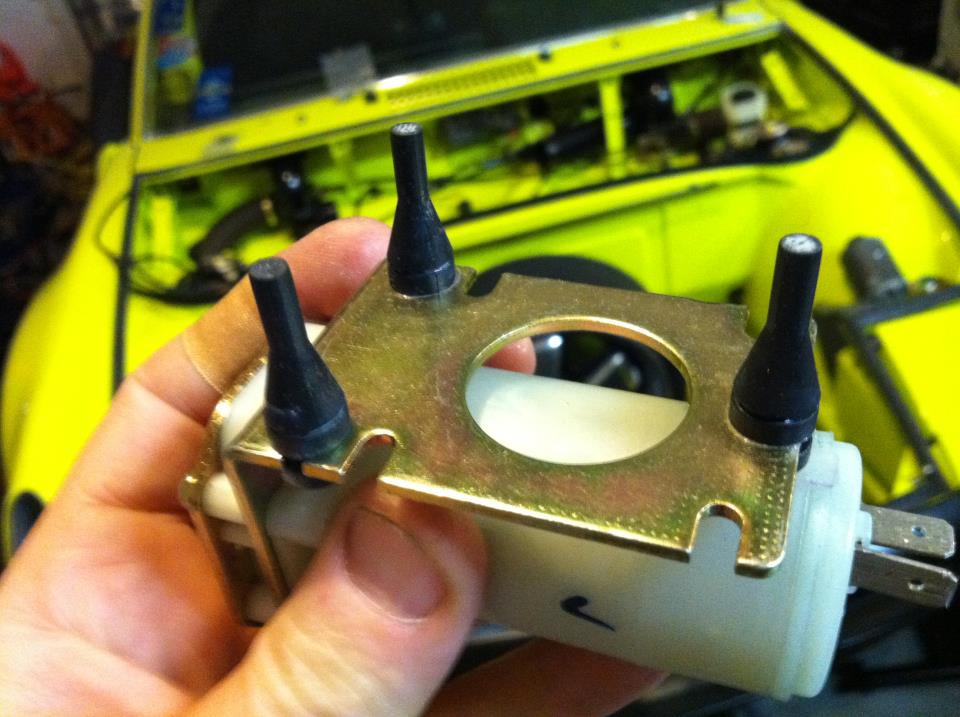

Eric_Shea
Dec 11 2012, 11:52 AM
Doesnt explain Jeffs question, & Andys comment? Why use a 924 switch assembly if the OE 914 switch will work?
Electric lead for washer pump all in one switch.
While the 924 switch will work, it is not the same as a 914 switch. The difference is it brings the switch closer to the steering wheel. If you have meat hooks for hands you tend to hit the switch while turning the wheel.

Eric_Shea
Dec 11 2012, 11:56 AM
Thanks Mark, It looks like the steering column cover is notched, not the switch. Please correct me if I am wrong.
No, it's the switch.
Eric_Shea
Dec 11 2012, 12:01 PM
914werke
Dec 11 2012, 02:10 PM
Eric are the rubber isolators still available new? Part # ?

914Sixer
Dec 11 2012, 08:28 PM
Isolators are still available, about $8 each. 914.628.741.00 Stopper
