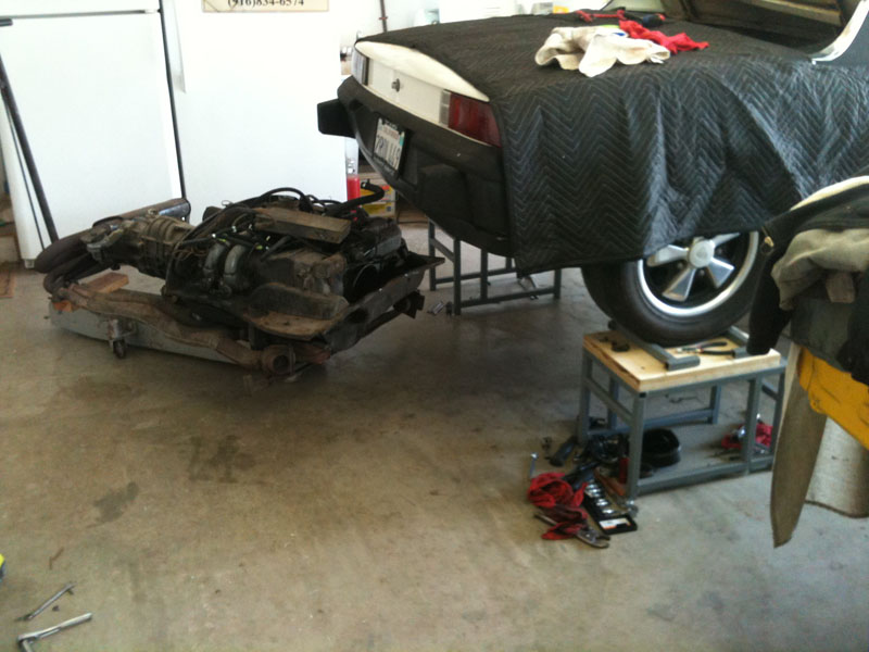

I use a cheap furniture dolly that you can find at Harbor Freight or Home Depot. Put the jack head in the middle of the dolly, raise it to catch teh engine, unbolt, lower the engine, and then you have it sitting on the dolly about 4-5 inches off the ground. Roll it out and you're good. You still have to get the back end pretty high up....but there's really no difference in height whether you take the wheels off or not.

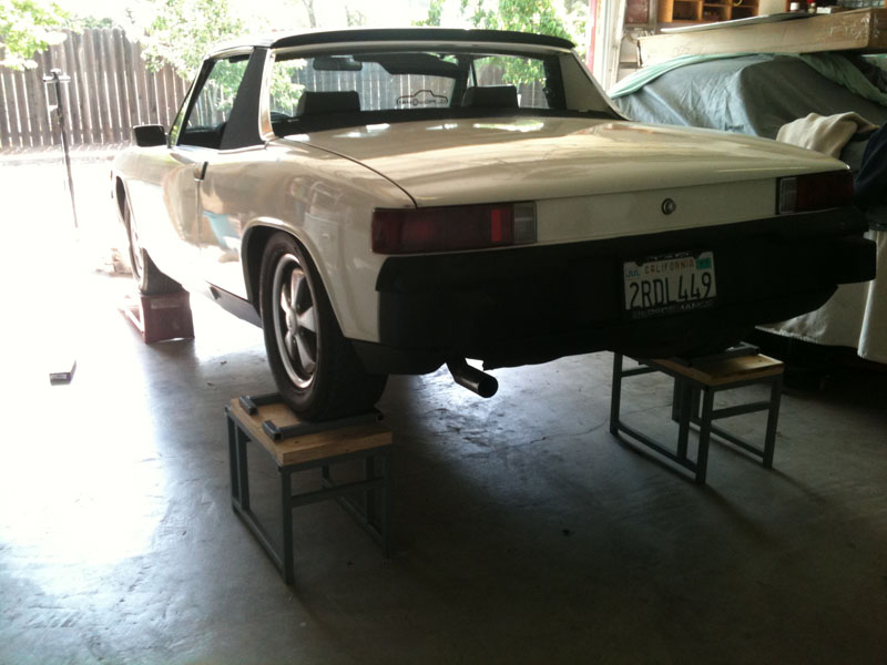

I use ramps for the front, then I have platforms I built for the rear tires to sit on.
Pulled and installed a few motors with this set up by myself.
I only had to remove the air cleaner, plenty of clearance to leave the wheels on.

I remove my 1st 914 engine this past August and debated which way to go. I ended up using a floor dolly and removing the rear wheels and rear valance. I used two floor jacks and lowered the car till the engine rested of the dolly. I used the procedure that was in the Pelican Parts how to. In retrospect I am glad I chose this because I found that balancing the engine and transmission as a solo could be difficult if one did not have a lot of experience. I was able to go slow and be careful and did not have any problems. The fuel rails want to hang up so you do have to be careful. I am very much a novice so the only advice I can provide is to go slow and be careful because the engine and transmission together was harder to manage than I thought. I did build my own dolly though. I used 2 2x4's and 3/4 inch plywood and I had 4 dollies. This was a little longer than the standard furniture dolly.

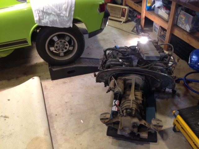

She's out! Tried the table jack, but it sits REALLY high even at its lowest height. Ended up doing it the HF dolly way... Sucked because I had already had the engine/trans out and on the table jack only to realize it was WAY too tall still... had to 3-jack it onto a separate dolly.. talk about scary and time consuming!
Ugh.. oh well.. official second notch on the ol' engine drop belt! Trying not to make mistakes on this one. Let's just say I labeled EVERYTHING!!
