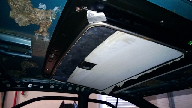

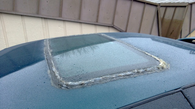

The sunroof leaks...step 1
Tear out the entire headliner, duct tape leak
Step 2...
Use a tube of window caulk to seal sunroof...very subtle. Believe it or not it still leaks.

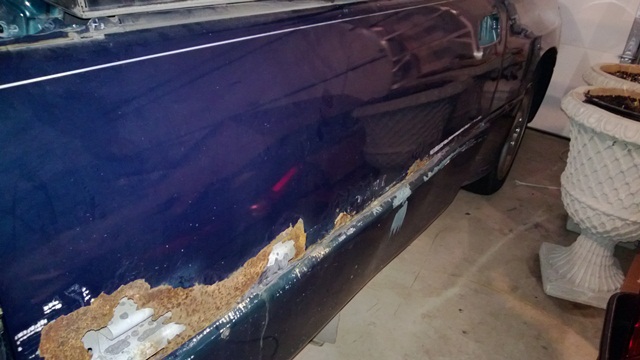

The SVX's "hell hole" appears to be the doors due to the odd window configuration.

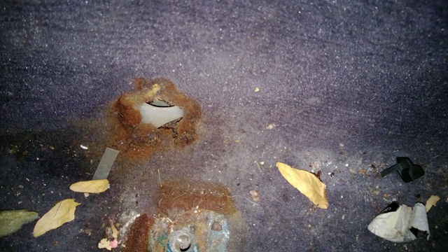

It was like old times when I tried to remove the driver's side lower seat-belt bolt. How many of us in the rust belt have had a huge chunk of rusty metal come off when you turn the bolt?

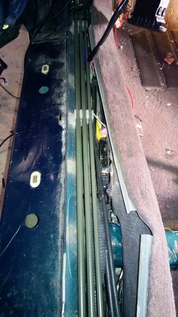

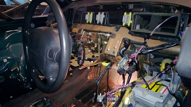

Another head-scratcher....these are the fuel lines...right underneath a plastic shield running up the drivers side long INSIDE the cabin.
If you part one of these be careful...there are electronics everywhere.

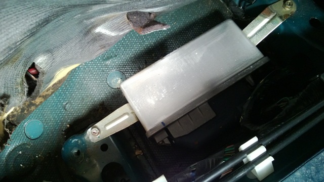

Under passenger seat:
Behind dash:

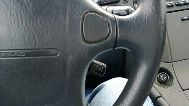

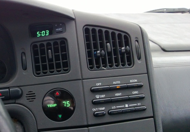

I plan to (try) to use some of the modern electronics.
Climate control:
Cruise control:

If our going to use the stock ecu (i recomend) the hole dash has to come out to get the wire harness "liberated". Big pain but just remove all the 10mm 12mm you can see and feel. There are bolts behind the ac vent covers.
Funny when the masive 8 foot wire bundle is cut down its almost as small as the teener.
You should check the engine wires harness for britleness, and plan on getting new vaccuum lines. I found most all the seals were hard or cracked on both of mine.

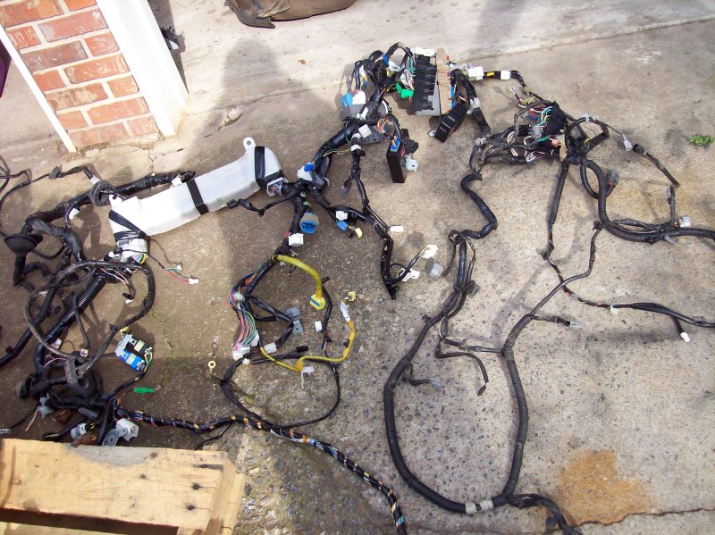

Funny you should say that...I just came in from the garage. Wow there are a LOT of bolts in that dash. Will post pics in the am when I pull that wire bundle out. Couldn't take another minute of it for today. Definitely using the stock ECU and a good portion of the overall harness. Seems easiest.
This car is starting to remind me of the old days when I had VWs. Tools required:
10mm socket
12mm socket
14mm socket once in a while
screwdriver
I'll definitely replace all of the rubber lines and re seal the engine as well since it's out. More to come...

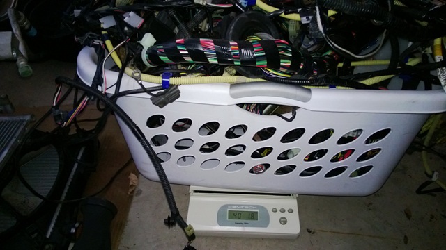

Thanks guys. Got the harness out...
Empty basket:
Overflowing basket:
Looks like it weighs about 40 lbs.
So far what I have tried to do is keep everything connected to everything else where possible, so the only things that are disconnected are the few things in the engine bay, which I color coded with several different shades of my daughter's nail polish. (IMG:style_emoticons/default/biggrin.gif)

Heres my WRX harness before and after. Label all the connectors and cut the wires from the main harness., Power and Grounds leads are shared in the harness.

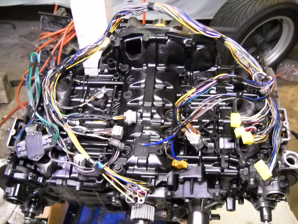

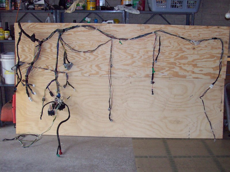

All the wires get trimed down to look like this
The svx is straight forward. The to engine side and the to 914 side. There are 2 o2's and the speed sensor need to be pluged into the subaru tranny. The svx ecu can also be upgraded to the "duel mode" stock/sport. but thats down the road.
jcl
