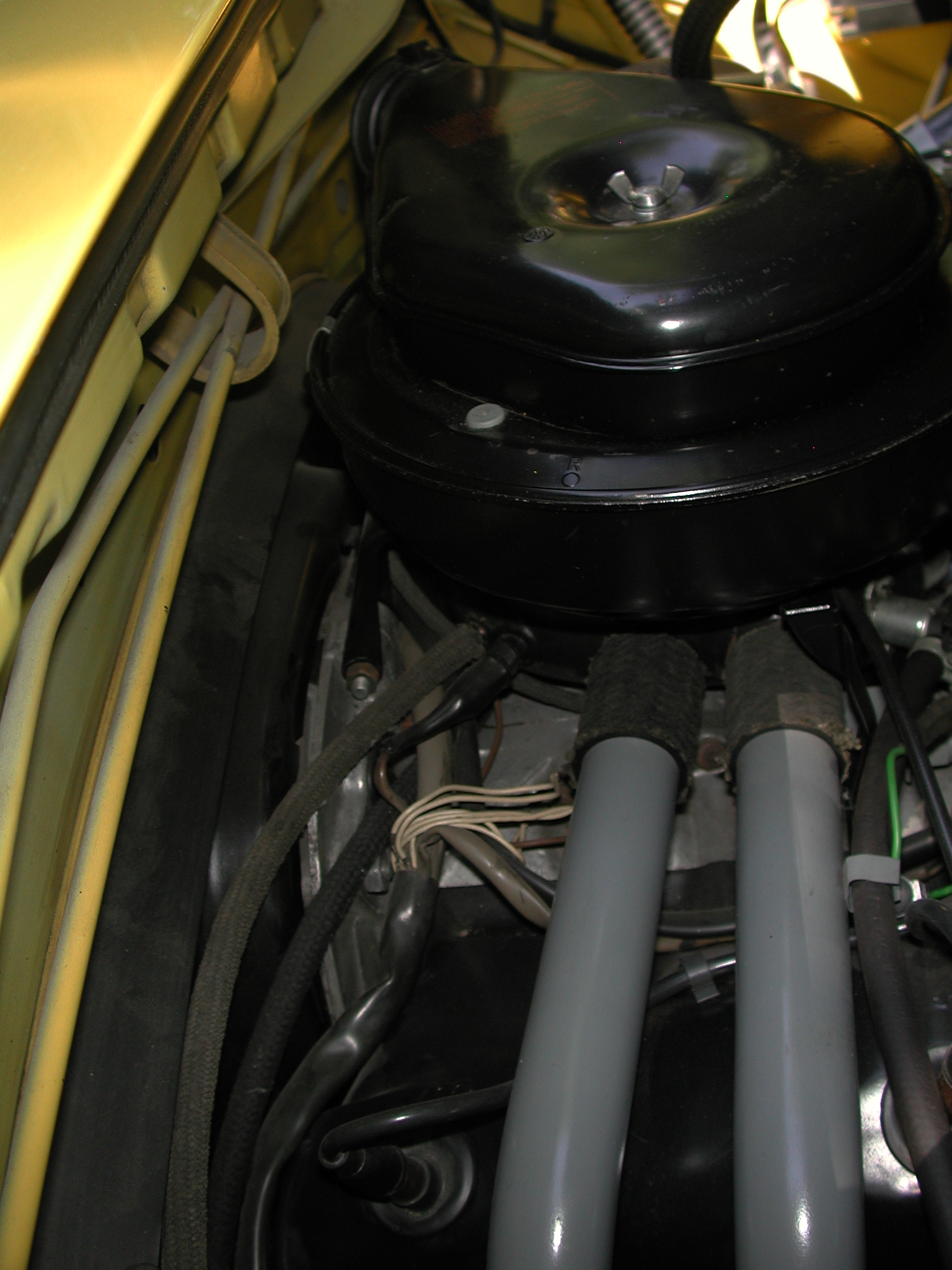

Your teener is a 70? It may be different from mine. I have attached a picture of my 73 1.7 where the cylinder head hoses connect. The hose going straight down with the clamp is from my air cleaner. I have a paper filter air cleaner.

Thanks for the reply but mine doesn't have the paper filter. It has an oil air cleaner. I think it is a pretty early version of the 1970 1.7L 914 because looking through the forum I have only found one that has a similar view and I can't see the full shot of the engine compartment. I have PM the guy with the picture but have not heard back yet.

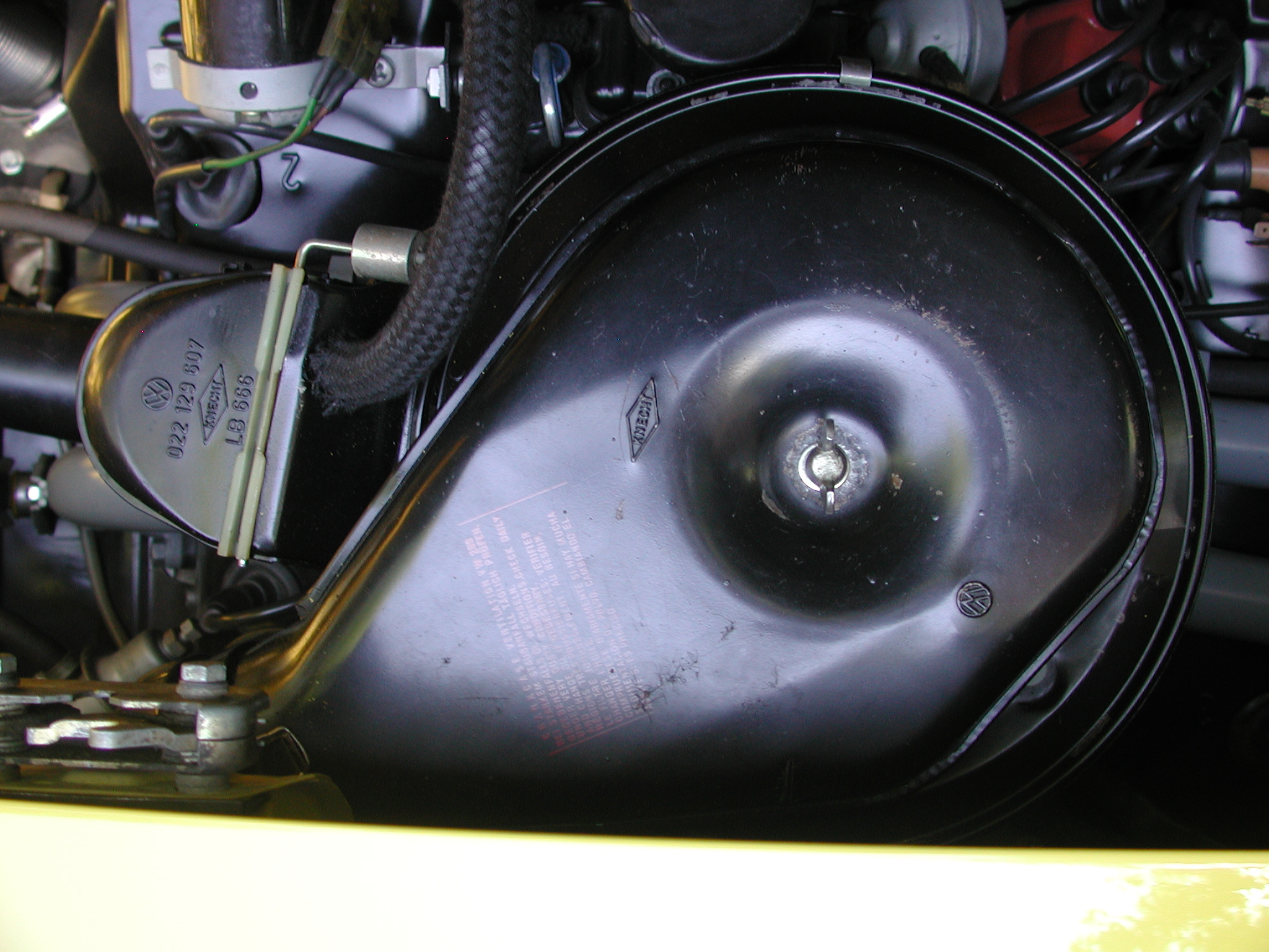

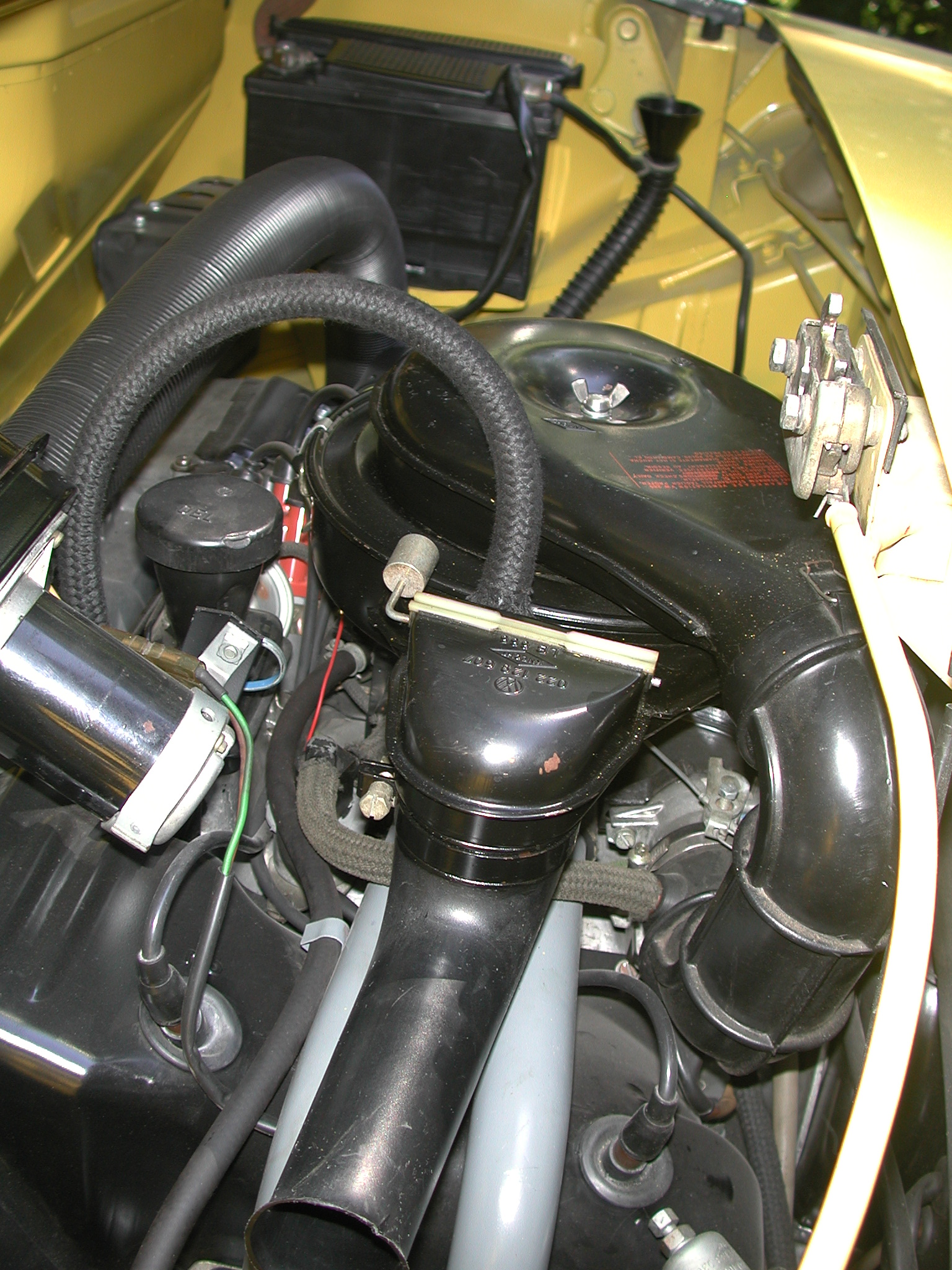

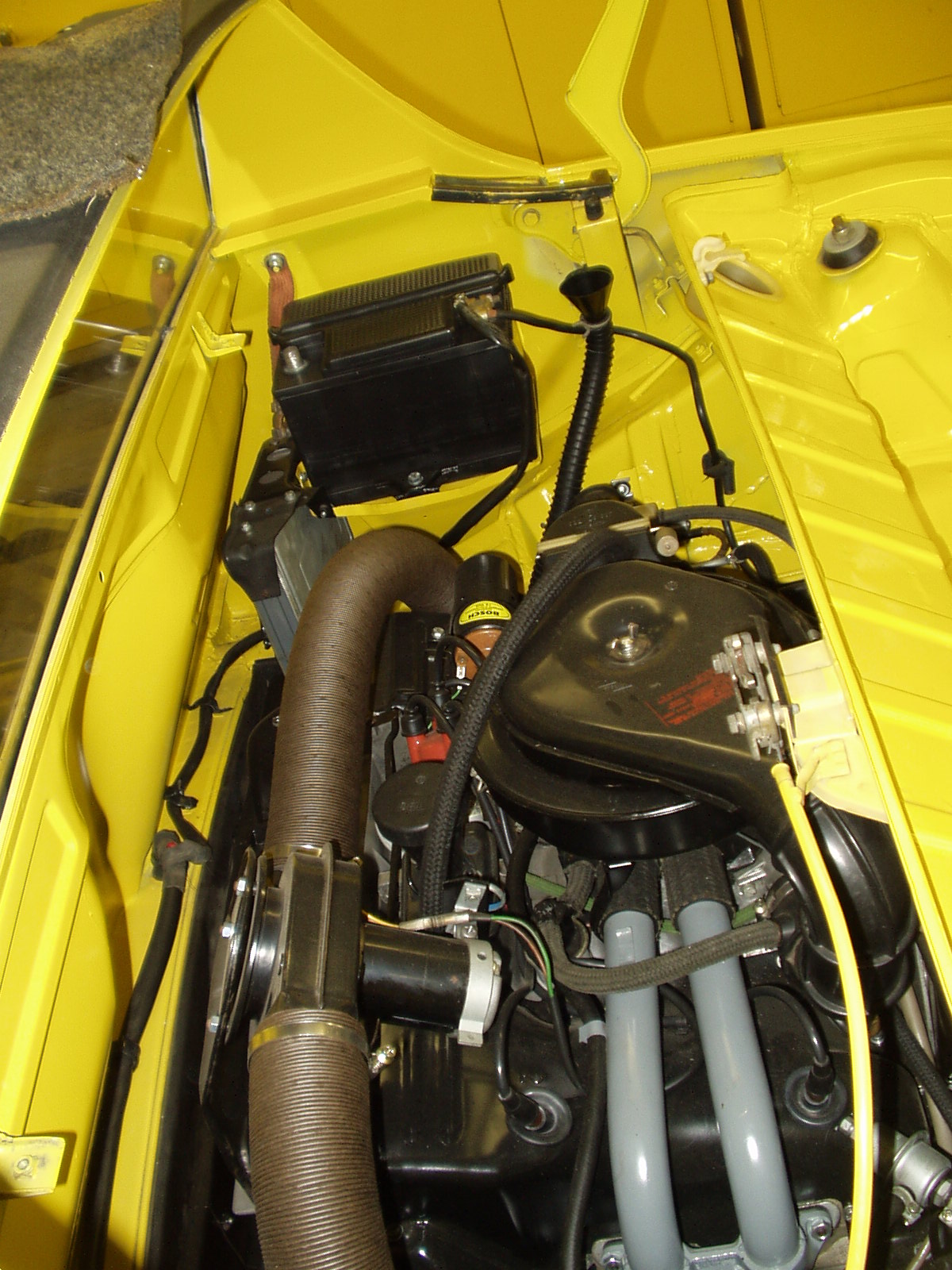

Do any of these photos look like your engine compartment?

Yes your engine area is exactly my engine compartment. Where does your cylinder vents go?

QUOTE(1970 Neun vierzehn @ Dec 30 2012, 10:09 PM) *
Aaron,
Wow! That engine looks like it just came off the showroom floor! (IMG:style_emoticons/default/beerchug.gif)
