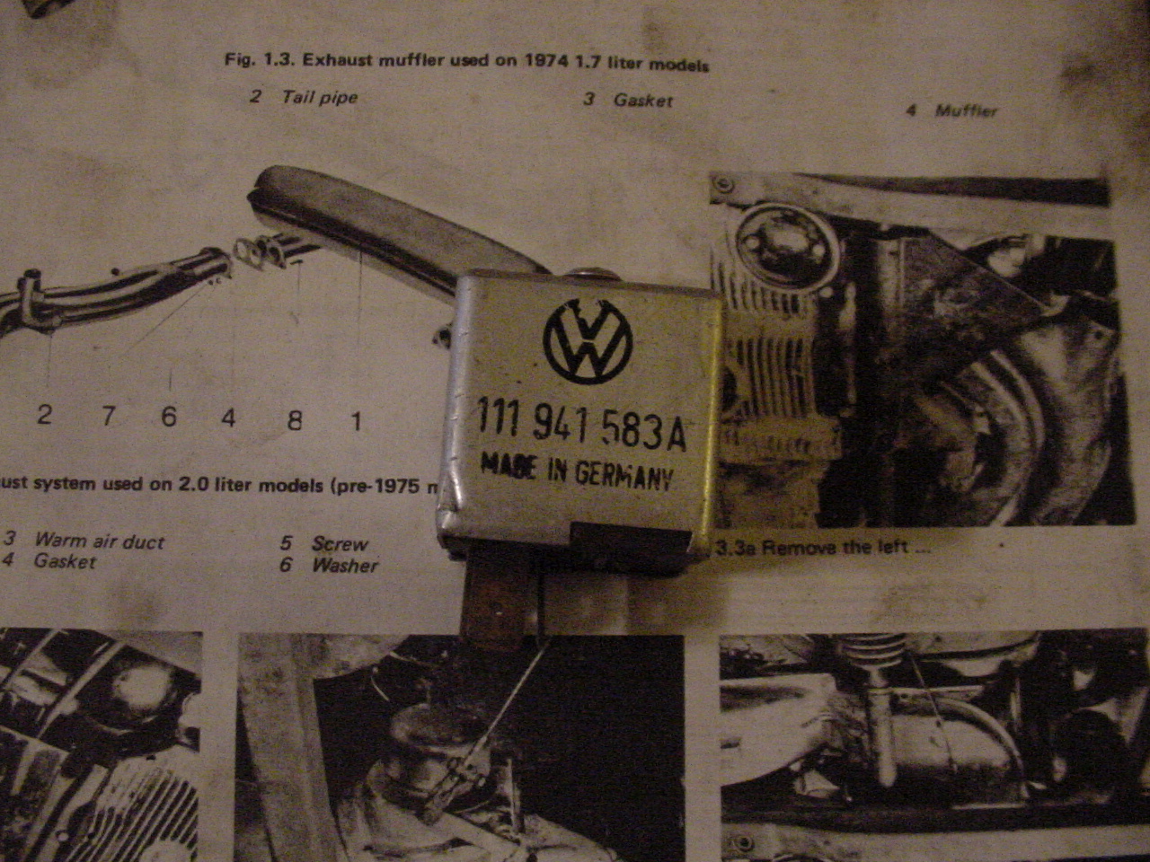

what's the # on the relay george?
k

Its the the standard Bosch 111-941-583-M84. I also have the 4 pole original version, but I'm pretty sure both are bad. I've opened both up before and got them working better, but they've always been problematic. I went to the junkyard with Mike's advice to find the SAAB unit, but there were no SAABs (guess that says something about their cars). I ended up just ordering one off of Ebay in hopes that I don't have to deal with this crap again.

no M84, just an A. 4 pins. what is the application dif for the 4 vs 5 pin?

QUOTE(rhodyguy @ Jan 5 2013, 06:20 PM) *
They are the same, AFAIK. Pelican lists the M84, which I guess is the 5 pin, but you have to jump the "31" to the hot "56" and it works the same. That is, if the relay itself is good.
