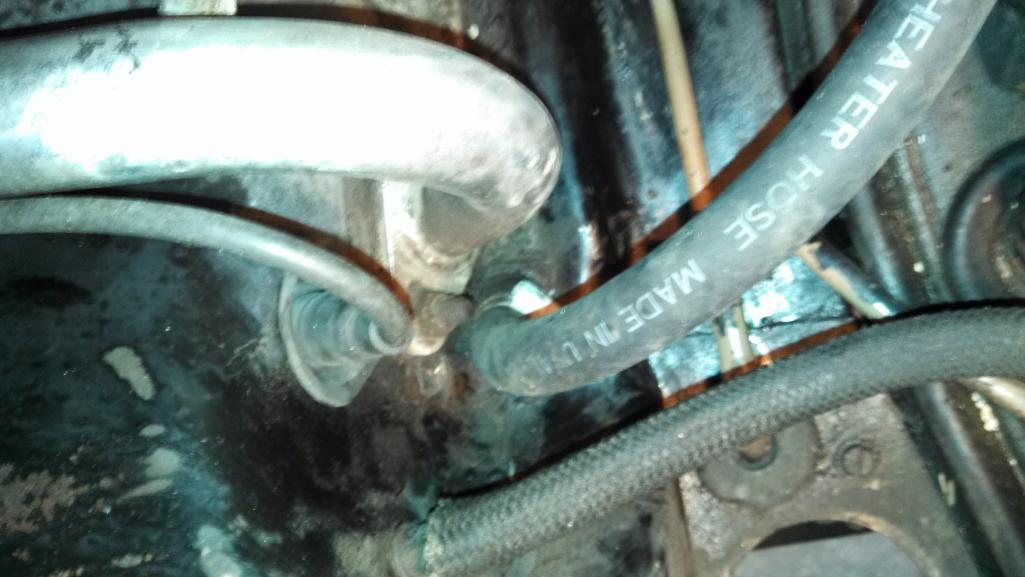

Thanks for reply. I was wondering what the spot is for a hose next to the #2 spark plug. I don't have anything plugged in there but looks like something should go there
Dave_Darling
post Jan 13 2013, 09:37 PM
914 Idiot
Posts: 15,328
Joined: 9-January 03
Member No.: 121
The #2 plug? That doesn't sound familiar. Is it on the carb manifold, or coming out of the head, or something else? If it's coming out of the head, then it's for the Positive Crankcase Ventilation system.
--DD
last337
post Jan 14 2013, 09:47 AM
Posts: 421
Joined: 4-December 12
From: New Orleans
Member No.: 15,221
QUOTE(Dave_Darling @ Jan 13 2013, 09:37 PM) *
--DD
I was talking about this one right next to that with the braided hose on it. That hose doesnt appear to go anywhere after that. It just goes into the cover it looks like.
