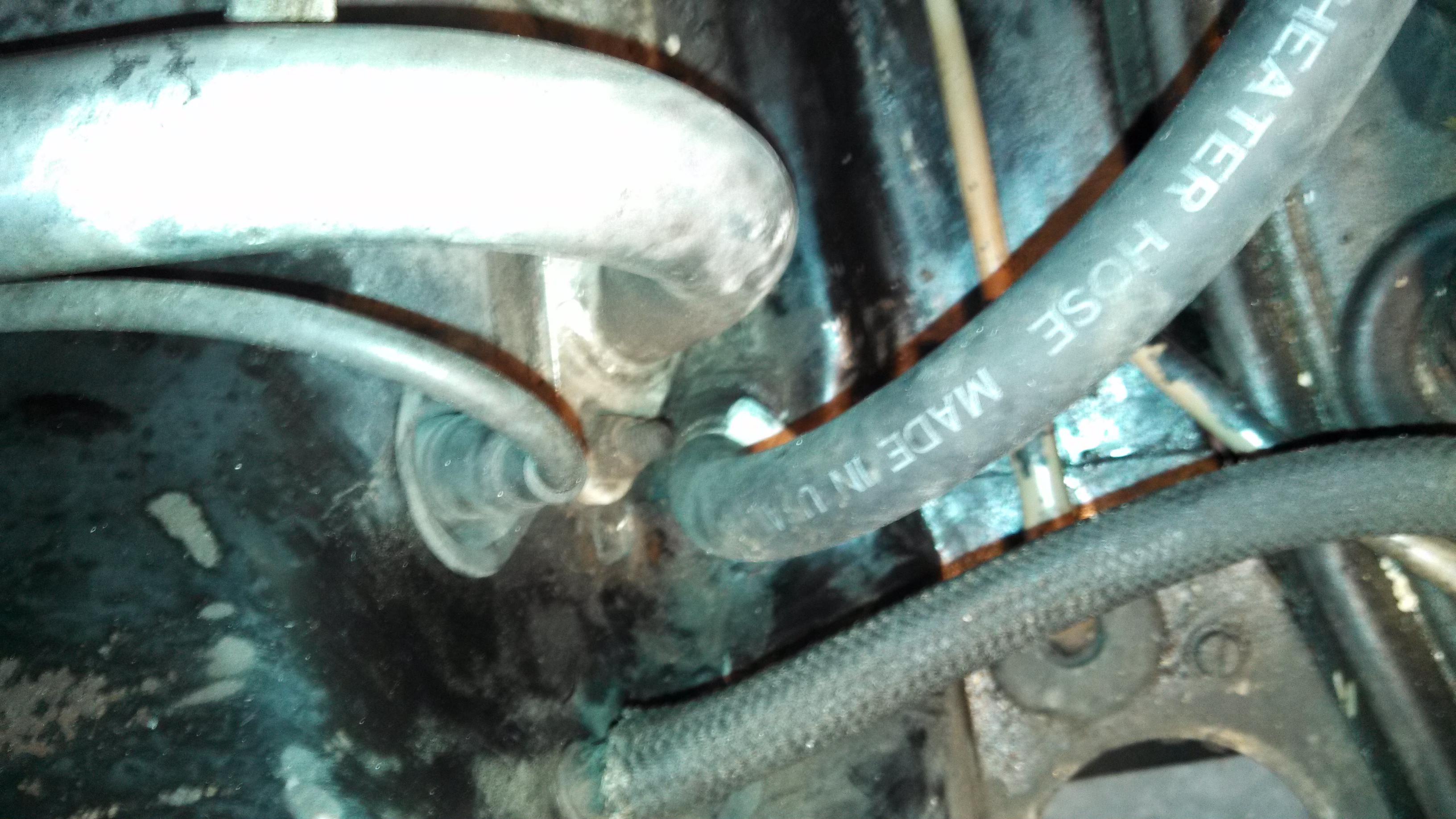

Thanks for reply. I was wondering what the spot is for a hose next to the #2 spark plug. I don't have anything plugged in there but looks like something should go there

last337
QUOTE(Dave_Darling @ Jan 13 2013, 09:37 PM) *
The #2 plug? That doesn't sound familiar. Is it on the carb manifold, or coming out of the head, or something else? If it's coming out of the head, then it's for the Positive Crankcase Ventilation system.
--DD
I was talking about this one right next to that with the braided hose on it. That hose doesnt appear to go anywhere after that. It just goes into the cover it looks like.
