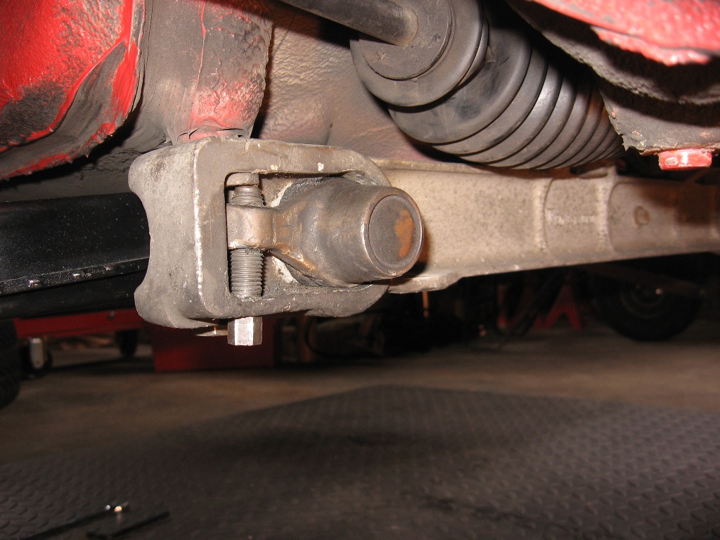

yes if you look at rear part of the front suspension arm were it meets the body you will wee that there is a small bokt that looks like igoes up into the crossmember, that isa the adjuster for the torsion bar that is the "spring" for that side of the front end.
the "lever" has the bolt go thru it, make the lever go up the body goes down
looks like this.

Simple to do, see pic above.
Measure at the bottom of the rocker panel, both front and rear.
I shoot for about 1/4 inch lower in front than in the rear when measured at the rocker panel.
Measuring the fender lip is filled with to many variations....
I also use a block of wood put right under the adjuster, measured to the exact height I want on one side...then go to the other side and slide the block in place....lower car to block...
Its faster than trying to hold a tape measure while adjusting the bolt...while trying to read the tape measure....etc...
If you want it perfect, sit in the front seat and have someone do it again with the weight on one side..
Then the car rides perfect with you in it, but looks odd when you are not in it.
rich
