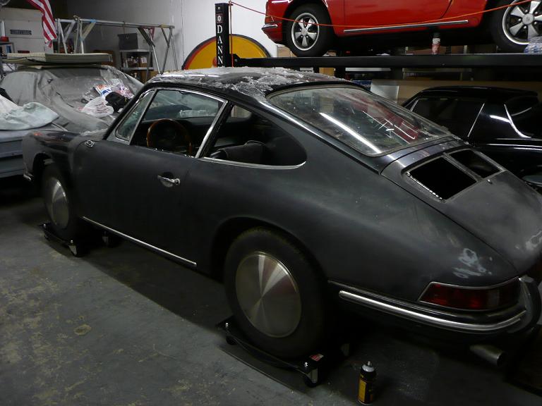

ya, original moons, wanted to give the 14 a soCal look plus im not a big fan of rivieras, which is what they are covering. so until i can afford the 911 fuch set-up the way i want, thought i would roll with these. here are some better shots. as ma be you read, i want to lower the front just a tap and i think it really add to the look.

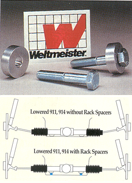

falconfp2001
You can buy some Bump Steer spacers also. This will allow you to lower the front by maybe 1/2" to 3/4" depending on how your front is now. You can find them on-line at Weltmeister I think.
There was a great write-up ona website that is no longer maintained.
Frank
johnpierre
QUOTE(falconfp2001 @ Feb 21 2013, 07:00 PM) *
Frank
cool thx.
euro911
Here's the tech article on 'How to install the bump-steer kit' Click here ...
Labor cost to install it is about the same as two cases of Starbucks Mocha-flavored Frapuccinos laugh.gif
... and the kit is relatively cheap, available from Pelican: Click here
