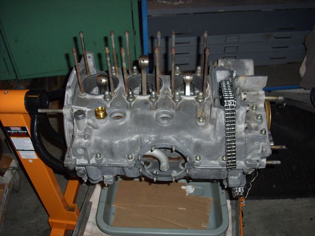

Standard engine stands can be used but the main advantage to a Porsche yoke is that it attaches to only one side of the engine case. On a six that means you attach it to the side with the oil pump and you can spin separate the case halves easily with one of them free to be lifted exposing the crank as well. Getting the engine onto the stand?
Generally you take separate the trans from the engine and attach the yoke. Then lift the engine (i.e with an engine hoist) up to the level of the stand and plug it in. That works with the Porsche yoke. If you use a "standard" yoke it'll likely be too close to the engine to have access to the flywheel and it may interfere with the pressure plate as well. There are flywheel locks to do crankshaft work as well.
Everything's easier with the Porsche yoke. If you have room for it on your bench, there is a bolt-down piece the yoke will plug into. It can also be used on a stand built to bolt it onto.
The downside is it's expensive at roughly $300 for the yoke by itself. But it can be used with a standard engine stand even though the yoke is a little too small for it.
If I were only gonna do one engine... or even two, I'd likely modify a standard stand/yoke and use a VW ring adapter instead of buying a Porsche yoke. More engines? Get the real thing.

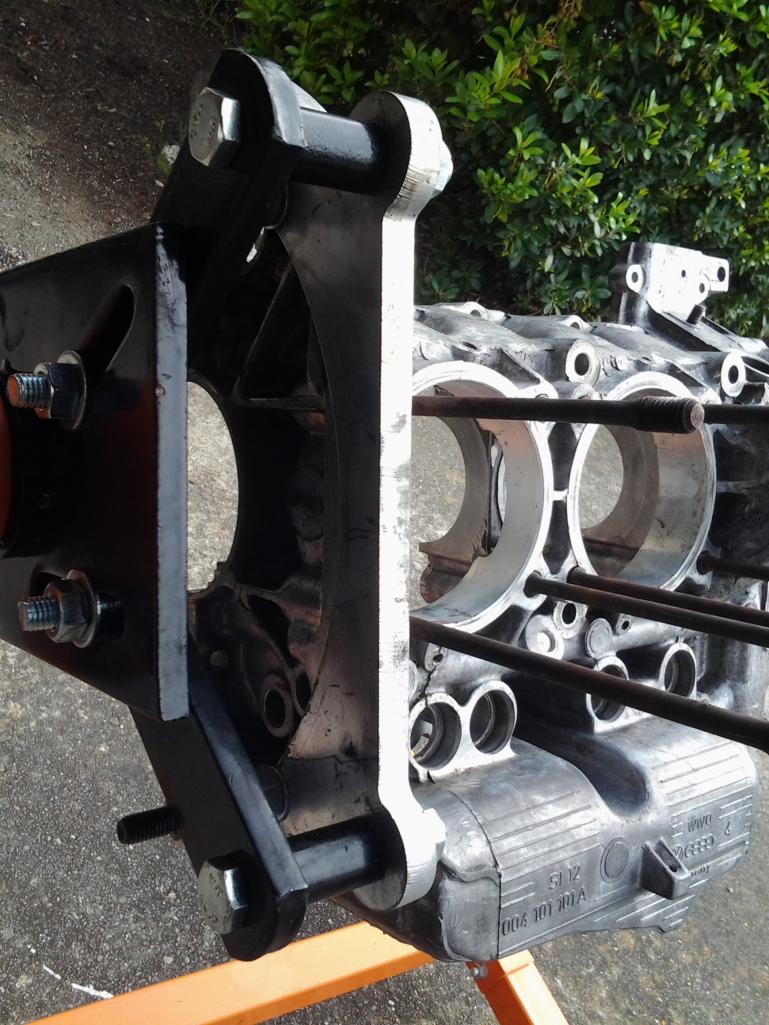

This is what I've got - an adapter for the regular stand.
Any way you go, make sure that the engine stands on the circular lip around the flywheel housing. The 2 arm stands that only hold the engine from the bolt holes are prone to fail and concentrate all the force in a single small location. I've seen a lighter bug engine case broken by the stand when one of the arms collapsed and the other broke the engine case hole that was connected to.

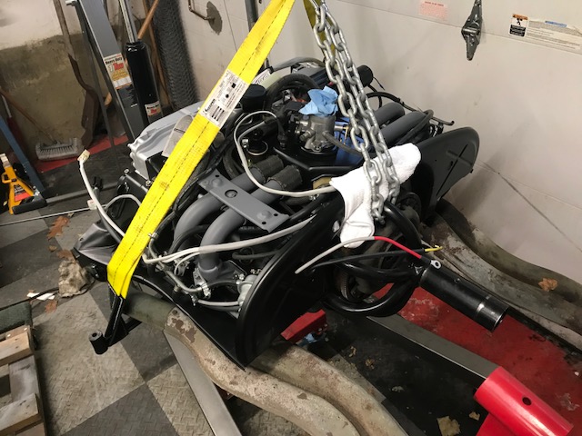

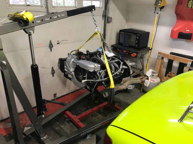

Remove the muffler and bracket, then separate the transmission. Bolt the yoke onto the engine. Then you can either lift it onto the stand with a few strong people...or use a small hoist/shop crane. I usually do it solo with a HF 1 ton folding crane, a webbed lifting strap and a length of chain. Slip the loops of a strap on each end of the engine bar, and wrap a length of chain around the top arm of the yoke. Adjust the length of chain so the hook is pretty much directly above the throttle body. Then loop it all directly through the crane hook or onto a carabiner first. A leveler helps, but not totally necessary if you go slow and guide the engine as you lift.
I have pics somewhere. Will look for them and post.
Be safe and good luck!
Edit: pics added...
