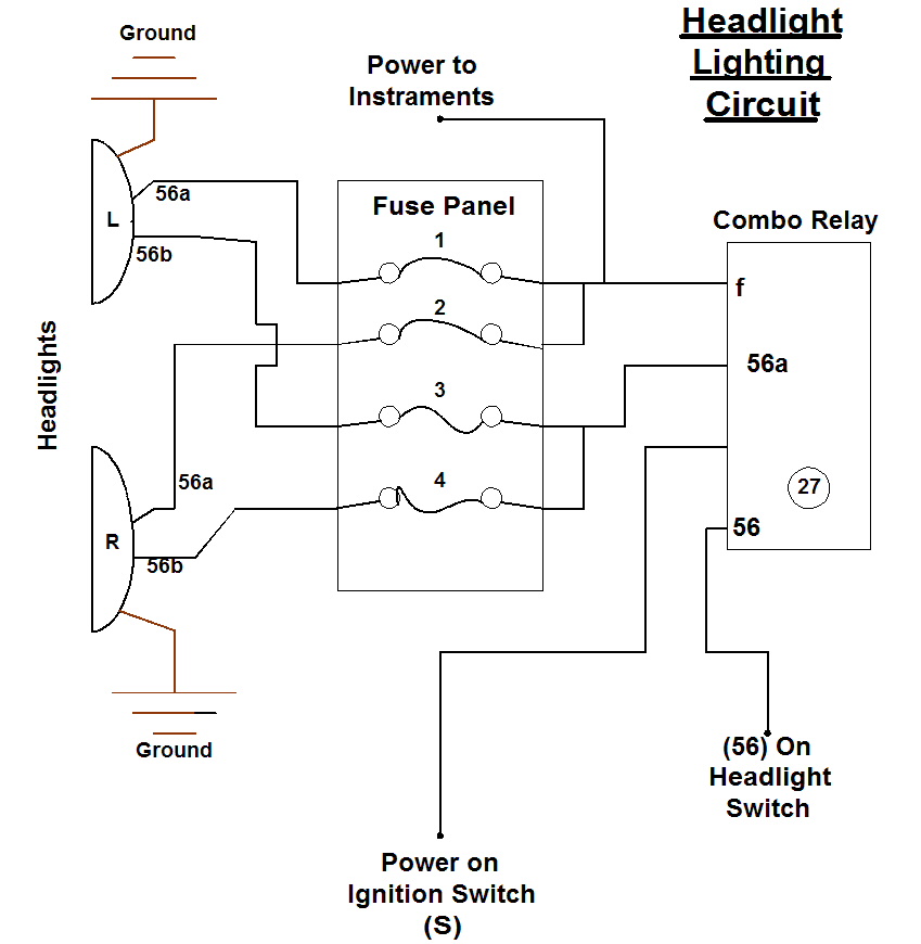

I would like to see the headlight system. I want to have my switch set up so only the orange corner lights ( front and rear) come on first; then the license plate, reds, and headlights come on with full on.
If your diagram can help me make this change, it would be greatly appreciated.

I like the idea, could you label more for us non-tech types.

I put a little more detailed description in the post attached to the first diagram. Is that what you meant? Glad to help. I am working on the headlight circuit right now, but it is pretty complicated so it is hard to make clearer.

Headlight Lighting Circuit.
Wire colors are as follows:
Fuses 1 and 2 to 56a (left and right lights perspectively) = White
Fuses 3 and 4 to 56b (left and right lights perspectively) = Yellow
Ground for bulbs = Brown
Fuses 1 and 2 to "f" on realy = White
Fuses 3 and 4 to 56a on relay = Yellow
From non designated pin on relay to headlight switch Pin 56= Red/White
From 56 on relay to ignition switch pin "S" = Yellow/Red
Fuses
Fuse 1 = High beam left
Fuse 2 = High beam right
Fuse 3 = Low beam left
Fuse 4 = Low beam right
The numbers in circles are the component designator numbers from the Haynes manual.
*The instraments get their power from fuse 1 on the relay side.

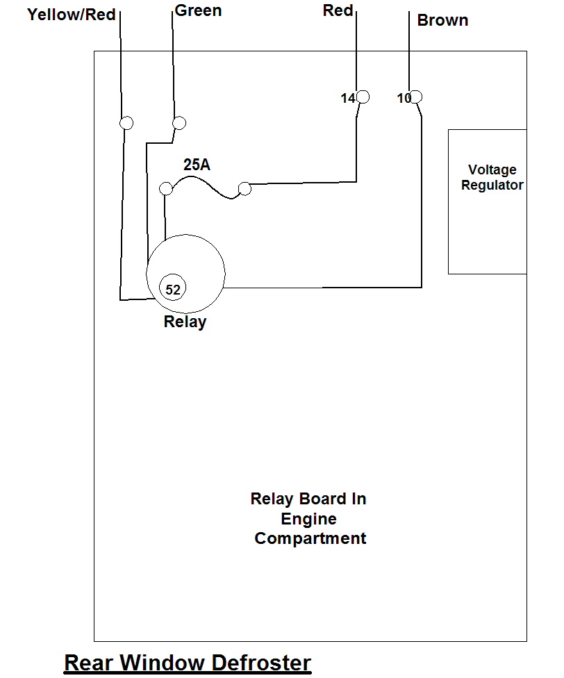

Exellent Doctor, Could you posibly make me a schematic for the rear window defroster. Joe

This is great stuff! What I particularly appreciate is the simplicity of it and how closely it resembles the physical stuff that you actually have to handle when you work on the car. Current diagrams drive me crazy, never have figured them out. What I need are things that translate easily to the physical items in the car. Great work!
Thats what I am trying for, I am glad to see that it is working out.
I'll draw up a rar heater defroster diagram when I get time. I still have a fog light one to draw and post.

Ask and you shall recieve (IMG:style_emoticons/default/smile.gif)
Here is all I got from the manual:
-Yellow/Red wire goes to defroster switch (hot when on).
-Green wire is the power to the defroster (ground must be on the other side of the defroster
-Pin 14 is straight from the battery. It is always hot. It goes to the 25A fuse.
-Pin 10 is ground
The relay for the defroster is (52) the one that is most forward on the board.
Any questions, just ask.
