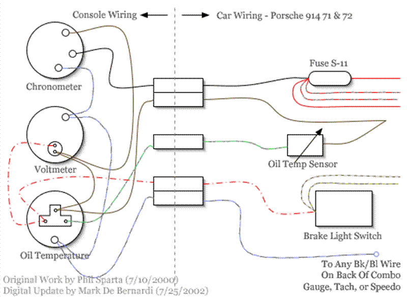

The wiring is already in the tunnel. You will need the gage harness or make your own. Either way it is quick n easy

Only 73 and later cars have the wiring in the tunnel for the center console.

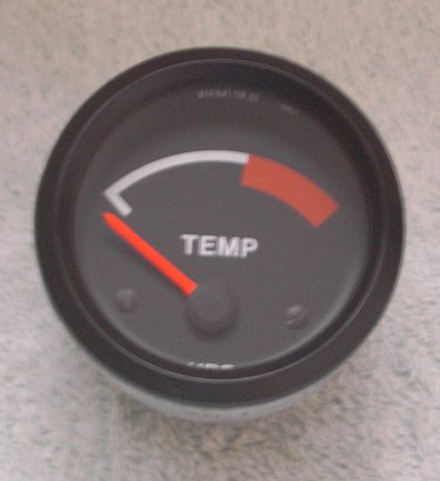

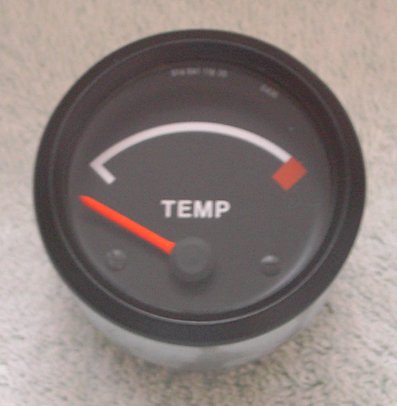

jp - there was only 1 style non-AC console & 2 AC styles for VPC & DPD AC dealer options. There is some good equipment by MY info at p914.com
PS edit - there were 2 different OT gauges used - 73 with a wider red band & 74-76 with a narrow one, & IIRC they used different senders at the engine too.

Your 914 isn't in the data base, so I can't tell which MY you have, but ray harvey & the others above are correct that 73-76 had the harness leads & quick-connect clip for the harness.
If not, you'll need to get the wiring diagram & some help to figure out which to cut into for the harness & hard wired them in using a quick-connect & short pig-tail, so you can easily disconnect it again for any interior or tunnel work, etc. (& not have to cut wires).

...- there were 2 different OT gauges used - 73 with a wider red band & 74-76 with a narrow one, & IIRC they used different senders at the engine too.

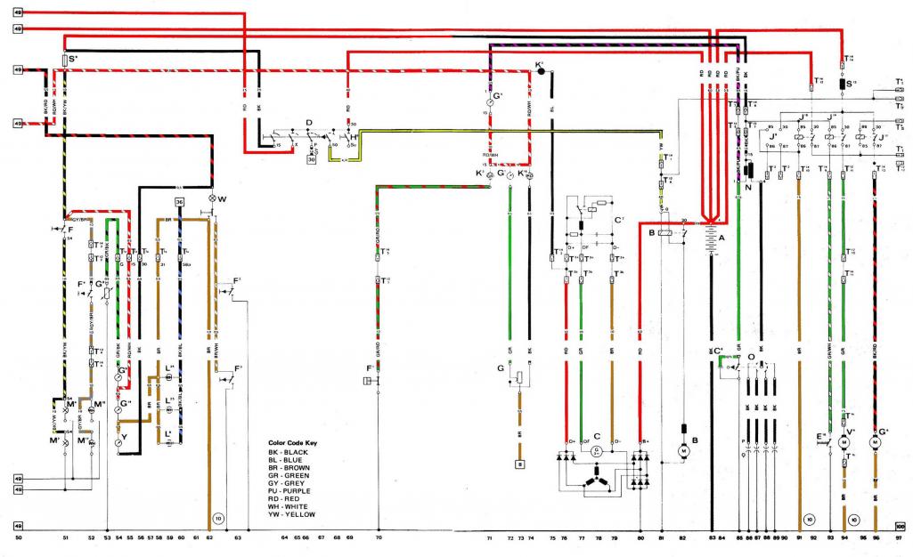

I think the console wiring is about tracks 51-63-ish in the schematic below

Yes the '73 gauge caused a lot of undue concern...peopl thought their cars were overheating because the red zone was too wide.
