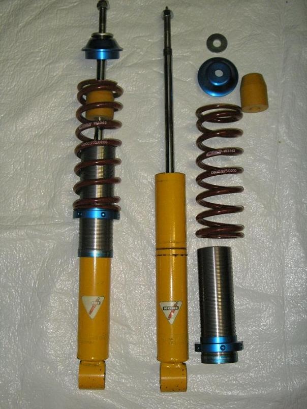

Rebel Racing. 2.25 x 8" springs 200 lbs on a /6. Old Koni shock on left for comparison.
