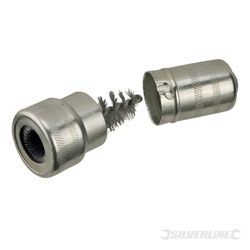

QUOTE(kg6dxn @ Apr 16 2013, 07:52 PM) *
Did you clean the battery cables and battery terminals?
Both can and do get glazed over with time. It is possible you have a bad connection even if it is tight. Use a wire brush or sand paper on all connections and try again.
That's what I was going to suggest. Clean both the posts and the insides of the connector clamps. I prefer using one of those little brush/scraper tools that's made for it.
A majority of the time when you have some electrical working but it won't crank, and especially if you hear a starter solenoid click, a dirty battery connection is the culprit.
