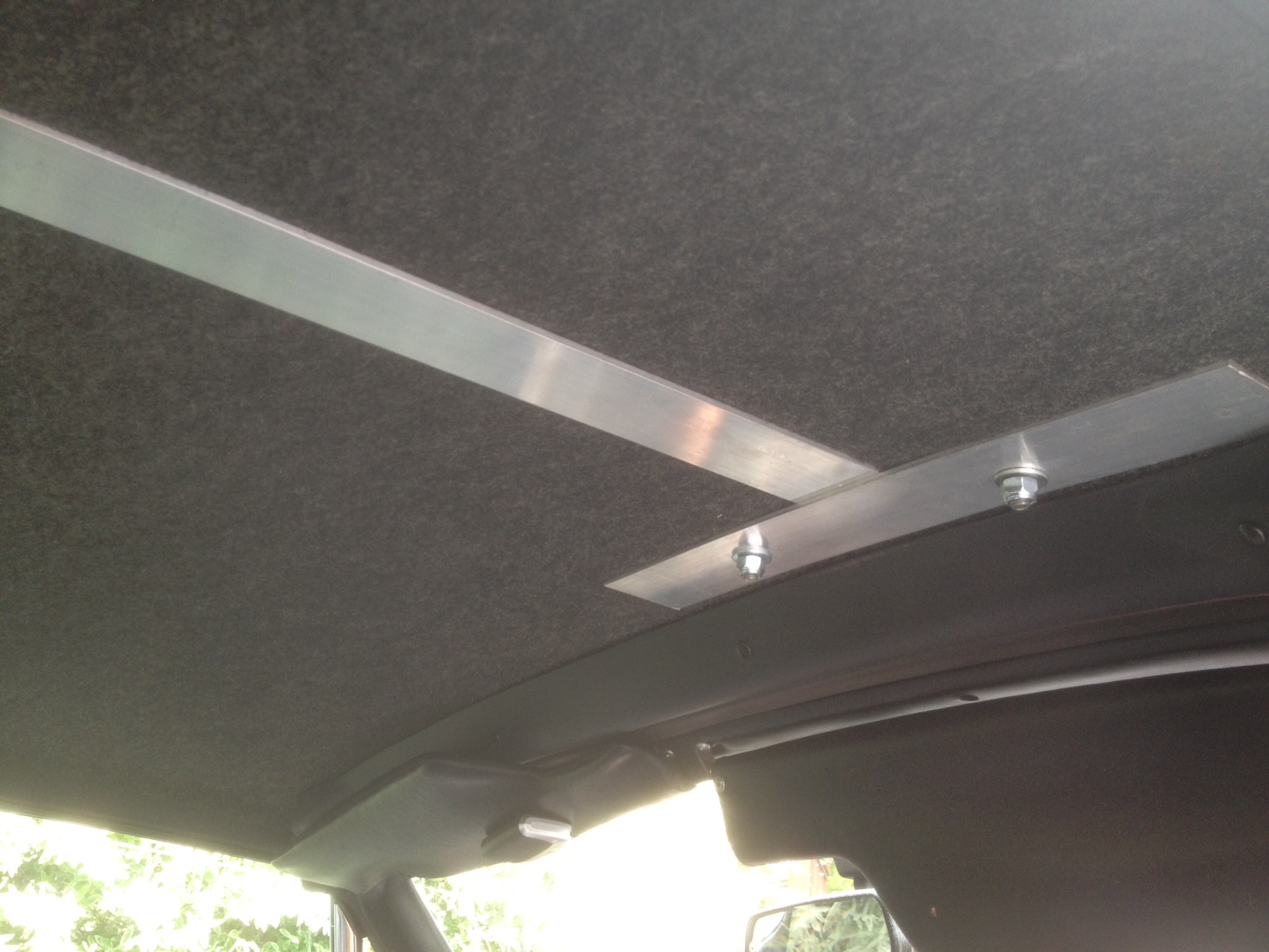

I found an extra targa top, bolted on a Yakima rack, reinforced the inside of the top and loaded a bike. Haven't taken a turn at speed, but it seems solid (IMG:style_emoticons/default/blink.gif)

Looks like a solid arrangement. Was there a reason you didn't use the bosses for ski racks under the targa bar over the engine compartment (three per side)?

Ok so lets cut him a little slack. He has a bike with down tube shifters so he can't be all bad. A little old school maybe but nothing wrong with that. But a bike on a car catches a surprising amount of wind. Considering how much that may flex the roof, I would try for at least one solid mount into metal. Given the amount of flex that can be introduced to the top there is potential for failure in the long term and extended use. Tying it in to the targa bar ski rack holes would may it viable for long term use.
May not be a priority for some, but getting a bike on a 914 is no small task. I have seem trunk mounted arrangements that used the targa bar.

(IMG:style_emoticons/default/blink.gif) Hope the targa latches are in good condition.

QUOTE(pcar916 @ Jun 11 2013, 04:17 PM) *
Thanks Ron, I didn't think to use those bosses as I wanted something that could easily be removed and didn't require any special hardware. This way I can quickly remove the entire top. I just hope the rack doesn't tear itself off the vinyl.

I would use a quick release mount for the front wheel and put the wheel in the trunk. I just think it makes for a more stable set up in general. Otherwise I think you have a good thing there looks fine...

(IMG:style_emoticons/default/WTF.gif) I would like to hear how your bike-rack works out after a good test run. I had a similar idea to make a tire-rack, but not so sure if the top would hold up to the task. If the bike-rack works out - next the tire-rack. (IMG:style_emoticons/default/smile.gif)
