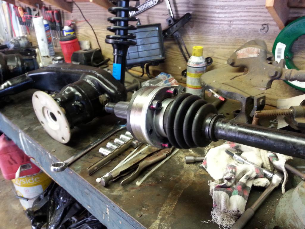

Okay....update.
Yes for all that have not done these.....they are not only a pain to find, but a nasty dirty job.
I ended up going with the type I replacements as I could not locate any good used ones. Mine were so scored and pitted I didn't want to do them again anytime soon.
Couple of additional questions for the World though some may have run into.
1. The Type I's have a recess here shown where the boot mates up against the CV.
The fit up isn't great. Should I RTV this side so the boot won't possibly sling grease?
2. Going without the paper gaskets as I have heard stories from others that they will
loosen the bolts over time. Any suggestions on the RTV to use? I was thinking the
most grease resistant and temperature resistant possible.
Thanks all in advance.

Rob, they never slung any grease out of that side when I ran them. And I will guarantee you that they come loose if you use a gasket.

QUOTE(914_teener @ Aug 14 2013, 12:08 AM) *
You got that right! Just did mine as well. Messiest thing I ever did on the car. Because of the massive 72hp power plant there was no pitting, scoring, damage, etc. Looked like new except for a slight shine shine in certain areas. They will probably shatter when I use them with the Subie.

QUOTE(Chris H. @ Aug 14 2013, 07:44 AM) *
Mine were shot....They were definitely the originals. I don't plan on putting any more than 120 horsepower through these.
Thanks.....yes.... Kent.... understand the tension should keep all in place.....
Thanks for the parts.
All is key in keeping the parts in tension....my quess is that is why the engineers used the thicker backing plates to better distribute the tension from the screws.
Any suggestions on the RTV on the other side......your right...I am not going to use the gaskets....hence the question.
Thanks in Advance.

Rob, I was trying to say they won't or didn't leak on that side so I'd say no to RTV on that side. Also, it might be a Royal FPITA to split that cup side apart after siliconing w/o doing some damage to the cover (thinner) side.

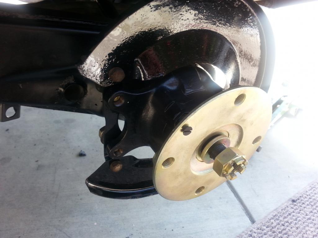

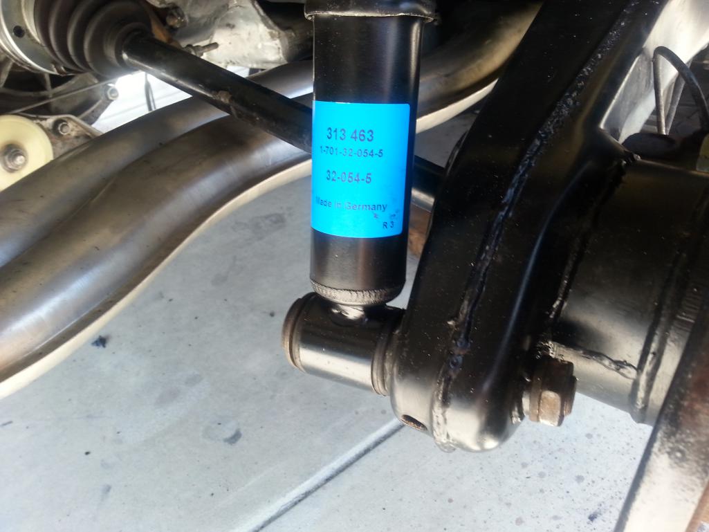

Everything fit up well. New bolts, schoor washers and shocks from PMB. New control arms all purty from Bruce Stone and bushings with zerks....gonna bolt everything in tomorrow.
Only thing I screwed up was the perches on the shocks. The hole is supposed to go towards the trans. This brought up a question:
When you re-install the spring, the Hayes manual doesn't say to or how much your should 'pre-load" the spring. It shows a spring compressor taking the spring off but doesn't mention putting it back on...what's the deal there?
Picture.....and yes...that is my daughters fingernail polish on the CV screws as tattletale marks.....just in case... (IMG:style_emoticons/default/laugh.gif)

almost done. No problems except I forgot if the brake backing plate goes on the inside of the control arm and the caliper sandwiches against it?

CV's are in. NO gaskets but black hi torque RTV.
Are these brake rotor gravel shields in right?
This seems the only way they can bolt in and my Hayes manual is too faded to tell.
I like the new shocks....they replaced the Kill Ya Backs's. We see what the difference is.
The passenger side caliper is alot tighter and really dragging on the rotor. The vent clearances were fine when I took them off. How could anything have changed?
