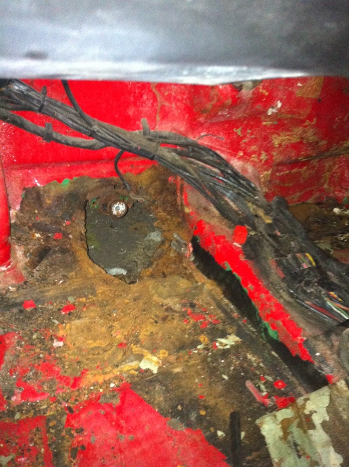

So today I was going to put in a new gas pedal since the old one wobbled and the hinge was shot. First indication of trouble was that the bolts would not come out of the old pedal, too rusted. After drilling them out and digging around a bit, I can now see the road from the driver seat. :-(
So what is the best method of repair here? Can I replace the supporting (and very rusted) metal under the floor board? I looked a bit but did not find this part in any diagrams. Who else has seen this issue?

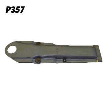

t collins
post Jun 29 2013, 06:24 PM
Posts: 3,270
Joined: 21-March 06
From: Virginia
Member No.: 5,754
Restoration Design Part No. 357

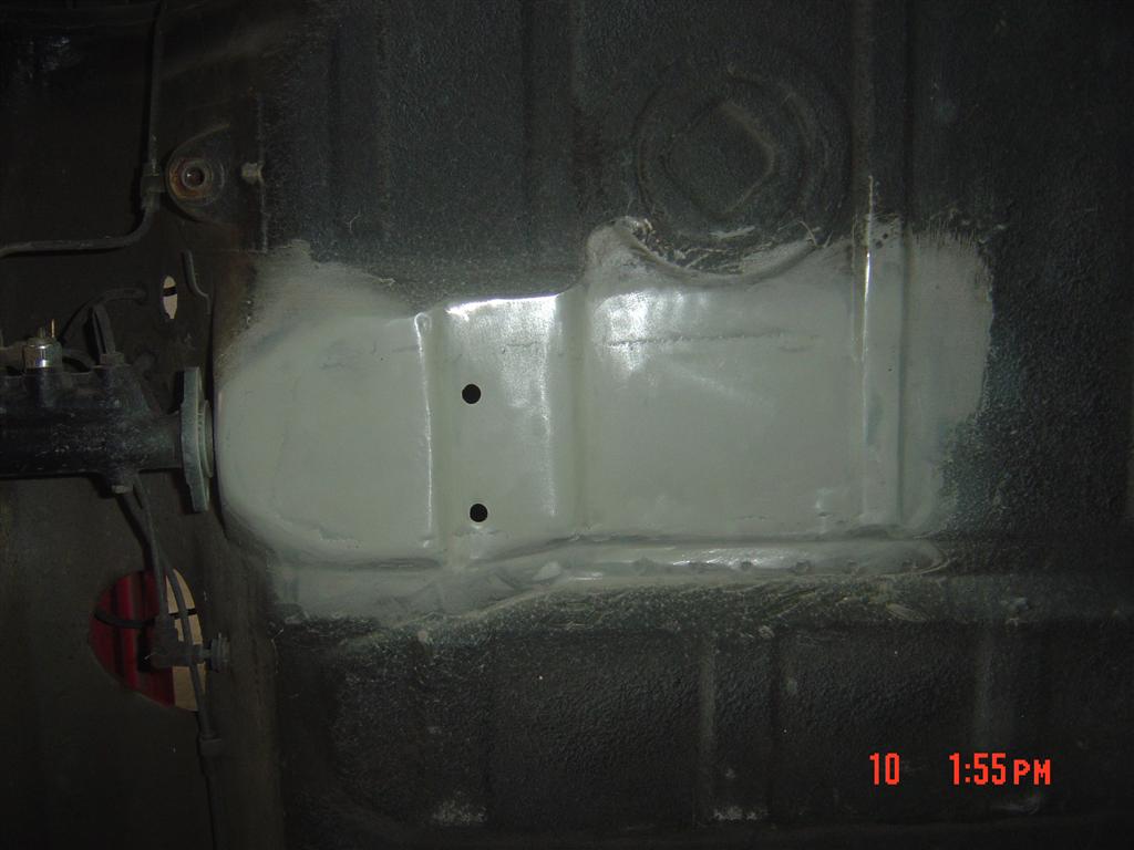

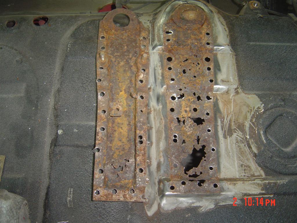

post Jun 29 2013, 07:48 PM
914-6 GT in waiting
Posts: 19,968
Joined: 19-September 09
Member No.: 10,825
Scotty b repaired this area on my car. New reinforcement from restoration design. Formed new floor piece from sheet steel. Check out the mepstein build thread.

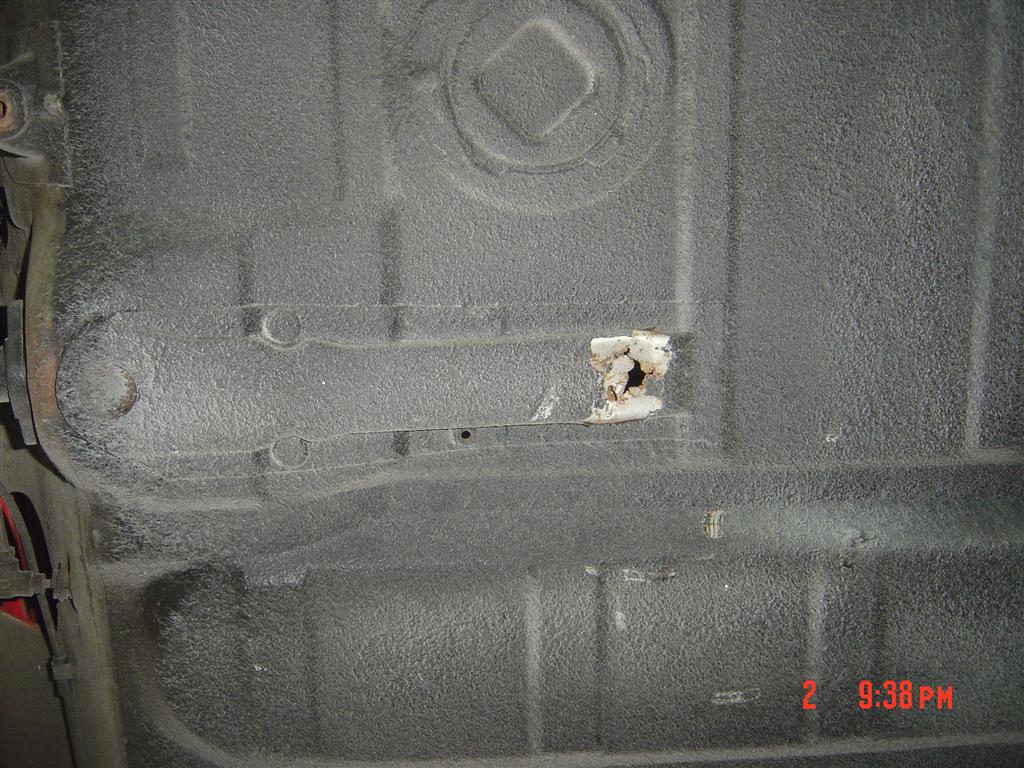

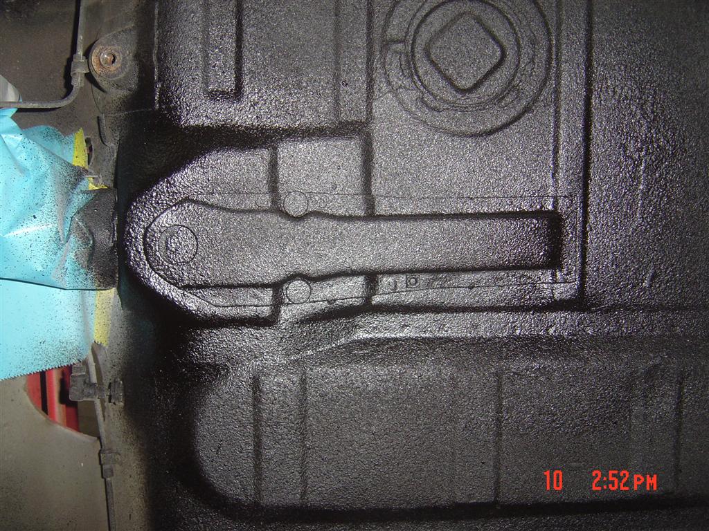

post Jun 29 2013, 09:57 PM
914-6 GT in waiting
Posts: 19,968
Member No.: 10,825
you can always find more rust on a 914 if you know where to look.
(pic #1 should be 3rd in line)
Attached Image Attached Image Attached Image Attached Image Attached Image Attached Image

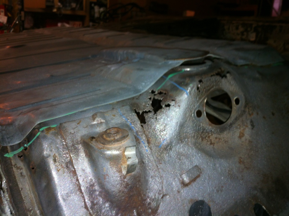

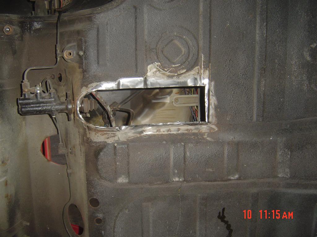

mramber
post Jul 22 2013, 06:00 AM
Posts: 87
Joined: 14-April 13
From: Minneapolis, MN
Member No.: 15,768
My car is back on the road! Thanks everyone for your help in finding the pedal reinforcement part from Restoration Design.
I'm adding pictures, but take it easy on me, this is the first metal fab that I have done since metal shop in high school (30 some years ago)
Attached Image Attached ImageAttached ImageAttached Image
sean_v8_914
post Jul 22 2013, 07:29 AM
Chingon 601
Posts: 4,011
Joined: 1-February 05
From: San Diego
Member No.: 3,541
going deep without fear! lookin good
