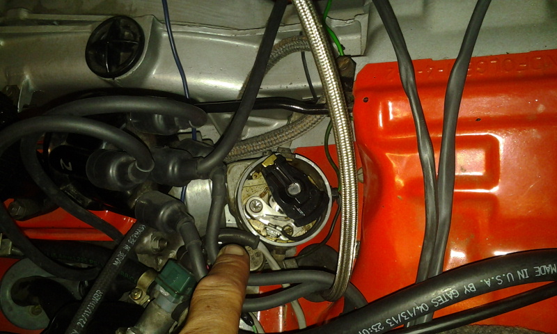

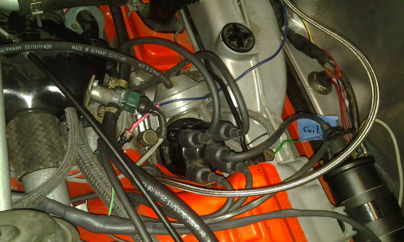

malcolm2
post Jul 9 2013, 08:42 PM
Posts: 2,749
Joined: 31-May 11
From: Nashville
Member No.: 13,139
QUOTE(timothy_nd28 @ Jul 9 2013, 09:28 PM) *
No need, your FI is working. We went thru the whole system earlier with no problems other than a disconnected ground wire (fixed now). You verified the working nature of the FI by using your noid light and physically seen fuel spraying. It's in the timing now or wrong firing order. Can you post a pic of your dizzy and a pic of the rotor when pointing to number one at TDC?
HERE YOU GO>>> Sorry the pictures are oriented differently, but the timing hole is closest to #1. So turn your head a bit, while looking at the 2nd picture.... (IMG:style_emoticons/default/happy11.gif)

malcolm2
post Jul 9 2013, 08:45 PM
Posts: 2,749
Joined: 31-May 11
From: Nashville
Member No.: 13,139
QUOTE(Mblizzard @ Jul 9 2013, 09:43 PM) *
I had a similar problem many years ago. It turned I had installed the dizzy drive gear 180 degrees out. All of my checks said it should run but I got nothing but flames out the exhaust pipes and backfires.
Not saying that you did the same, but it took me along time before i checked the drive gear.
That may be where I am heading... but I got no flames. Is #1 on the dizzy closest to the driver?

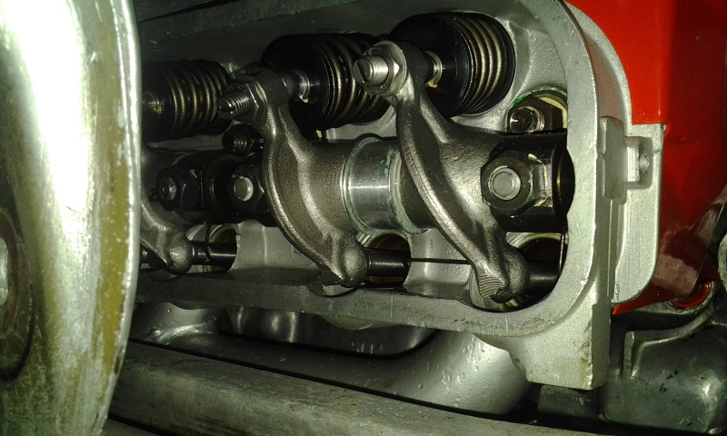

malcolm2
post Jul 9 2013, 09:13 PM
Posts: 2,749
Joined: 31-May 11
From: Nashville
Member No.: 13,139
QUOTE(malcolm2 @ Jul 9 2013, 09:57 PM) *
QUOTE(timothy_nd28 @ Jul 9 2013, 09:47 PM) *
K, can you remove the valve cover and wiggle the rocker arms for the number one cylinder. Do they wiggle ?
I did that on the other side, to see if I was getting movement. Give me a minute and I'll check #1 for wiggle.
the left one wiggles. the right does not... just thought of something.... should I have the rotor button pointing at #1? It is not in this picture.
I rechecked at very close to #1 TDC and I got NO WIGGLE. One valve is UP, and one is DOWN. I can snap another picture?
timothy_nd28
post Jul 9 2013, 09:17 PM
Posts: 2,299
Joined: 25-September 07
From: IN
Member No.: 8,154
QUOTE(malcolm2 @ Jul 9 2013, 06:57 PM) *
You should have valve lash wiggle on both rockers when piston number one is at TDC. Since you don't, tells me that number one isn't at tdc or valve lash isn't set right. Worse case scenario the cam wasn't meshed up with the crank correctly (I hope not). Your dizzy drive gear could be off as well. First thing is first, you must find TDC on piston one, making sure both rocker are relaxed and move by hand.

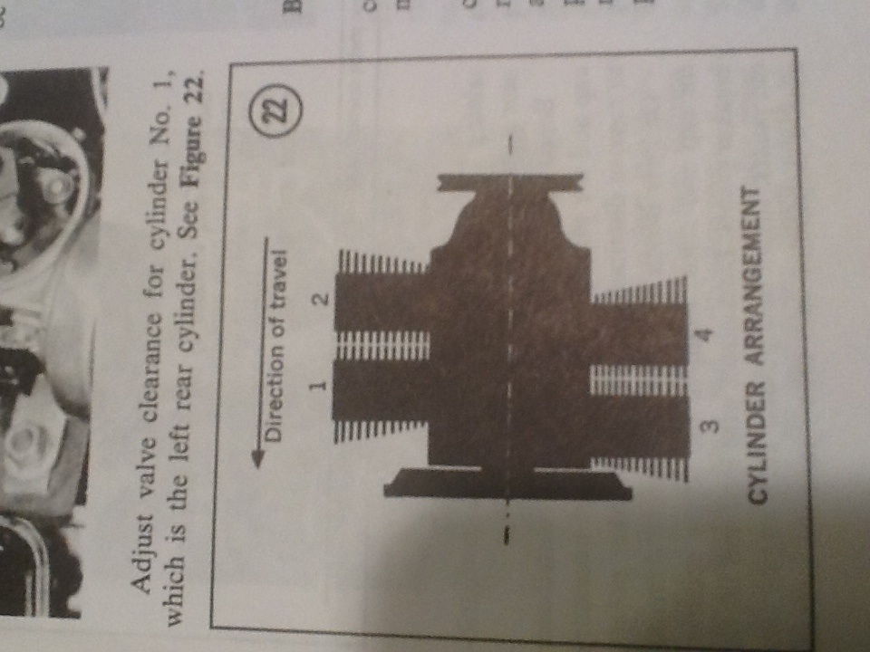

Mblizzard
post Jul 9 2013, 09:28 PM
Posts: 3,033
Joined: 28-January 13
From: Knoxville Tn
Member No.: 15,438
Verify that you #1 viewed from sitting in the car, is the left rear cylinder.
Disregard the arrow that says direction of travel.
