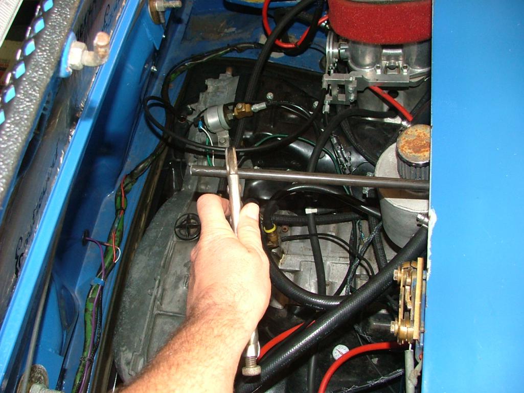

many long extensions with a 10mm socket on the end.
The locking mechanism has two 10mm bolts, one on either side of the lock.
Remove them.
You access it via the cup that normally hold the roof latches....just push them into the trunk.
Socket goes in the drivers side, light source into the passenger side.
Lay on the trunk to see what you are doing.

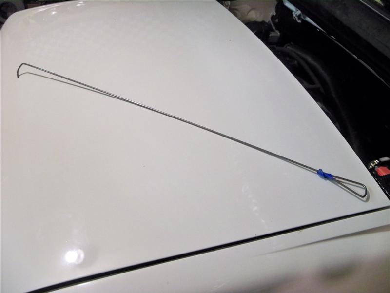

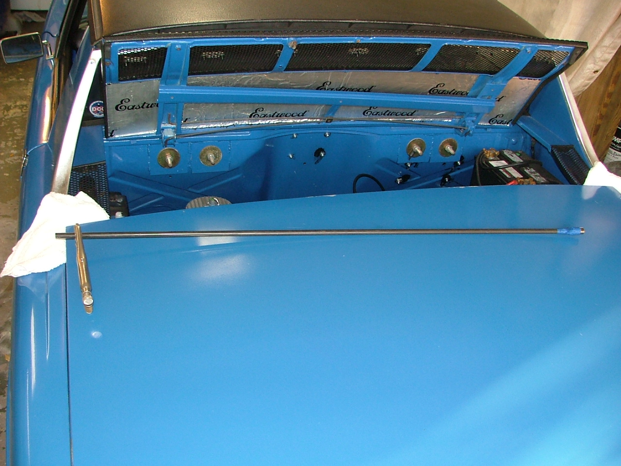

Thats the hard way. (IMG:style_emoticons/default/headbang.gif)
Do a search on home made tools in that thread is pic of one I made specifically for his purpose.

I found a long set of extensions too wobbly to remove the 10mm bolts holding the lock on.
Made a "tool" for removing them.
Steel tube with 10mm socket pounded onto one end and taped on for paranoia.
Grab with vice grips.
Remove hinge bolts (I have gas struts instead of the dreaded spring rods).
Lift up end of trunk lid and insert tool.
John

914werke
post Aug 13 2013, 01:42 PM
Posts: 11,294
Joined: 22-March 03
From: USofA
Member No.: 453
Rich, Yes
Robert, coat hanger may work but I found the wire gauge to thin so I made that one pictured out of some thicker gauge material I Picked up at the local home improvement place.
