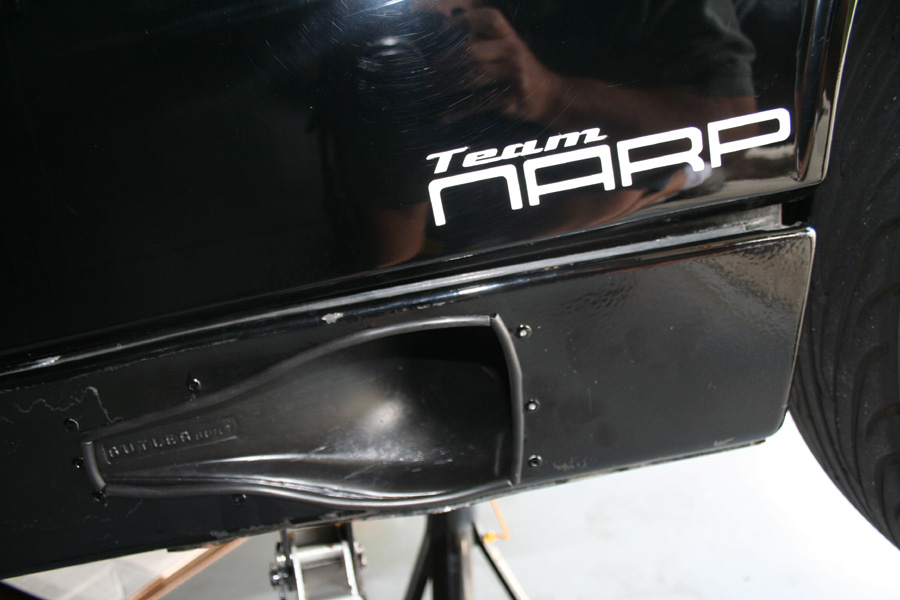

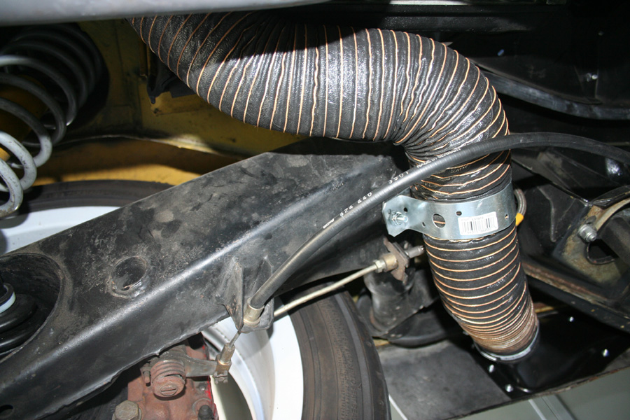

Elliot Cannon
post Aug 12 2013, 11:19 PM
Group: Retired Members
Posts: 8,487
Joined: 29-December 06
Member No.: 7,407
NACA scoop in the rocker panel ducted to a small seatrab cooler under the trunk.
