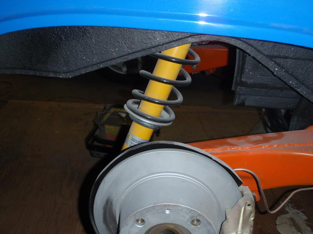

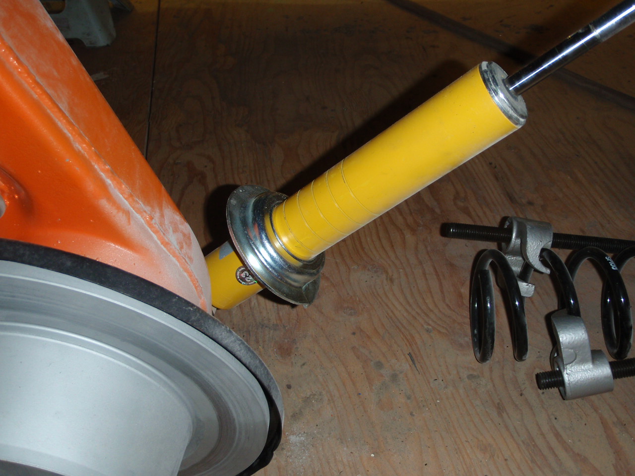

Installing new Bilstein shocks with 140 lb springs. took off stock springs with Koni's with a spring compressor. I didn't really need the spring compressors for the Bilstein's and now they slip off the bottom cradle. The Bilstein cradle is flat where the Koni's is more formed, like the top piece from the car.
What am I doing wrong here (note I installed them backwards to see it there was a difference). which reminds me...which end is up the small coils or the larger?

that silver plate is upside down - I think

Yup lower spring plate is upside down. And the spring will wobble around till you get some pressure on them. Normal

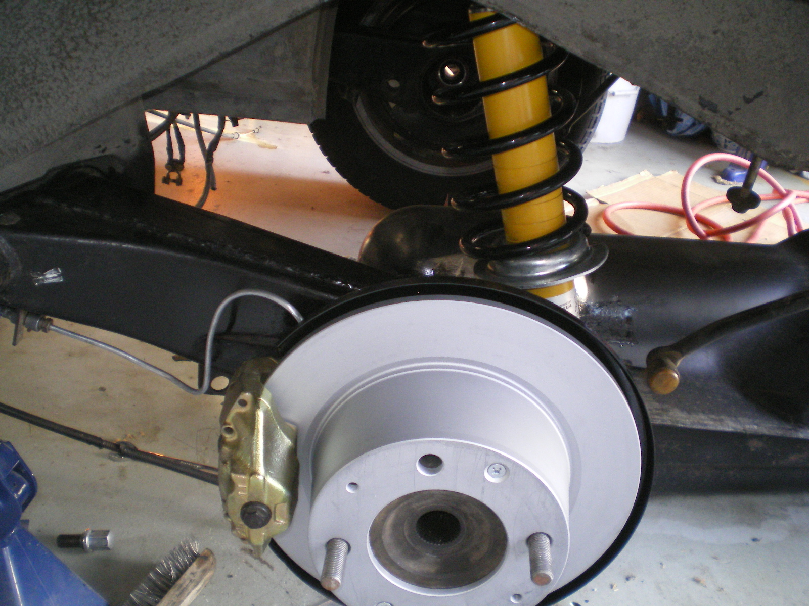

Here is your exact setup. (IMG:style_emoticons/default/agree.gif) Once it's down and your not going neg G not a problem. Otherwise zip tie it on the top. You'll need to select a ride height on those. If you've got a 6 try the 4th perch. (IMG:style_emoticons/default/beerchug.gif)

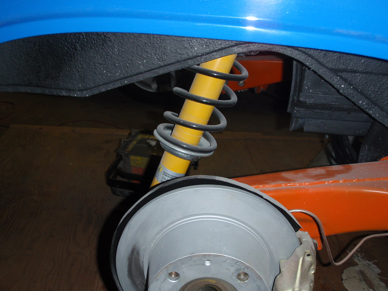

Your telling me these are upside down?
Sorry for hijack....
Dammmmmmmmmm (IMG:style_emoticons/default/hissyfit.gif) (IMG:style_emoticons/default/hissyfit.gif)

Well good thing I looked at this thread. Wonder what else I installed upside down (IMG:style_emoticons/default/idea.gif) They need cleaning anyway.... (IMG:style_emoticons/default/wacko.gif)
