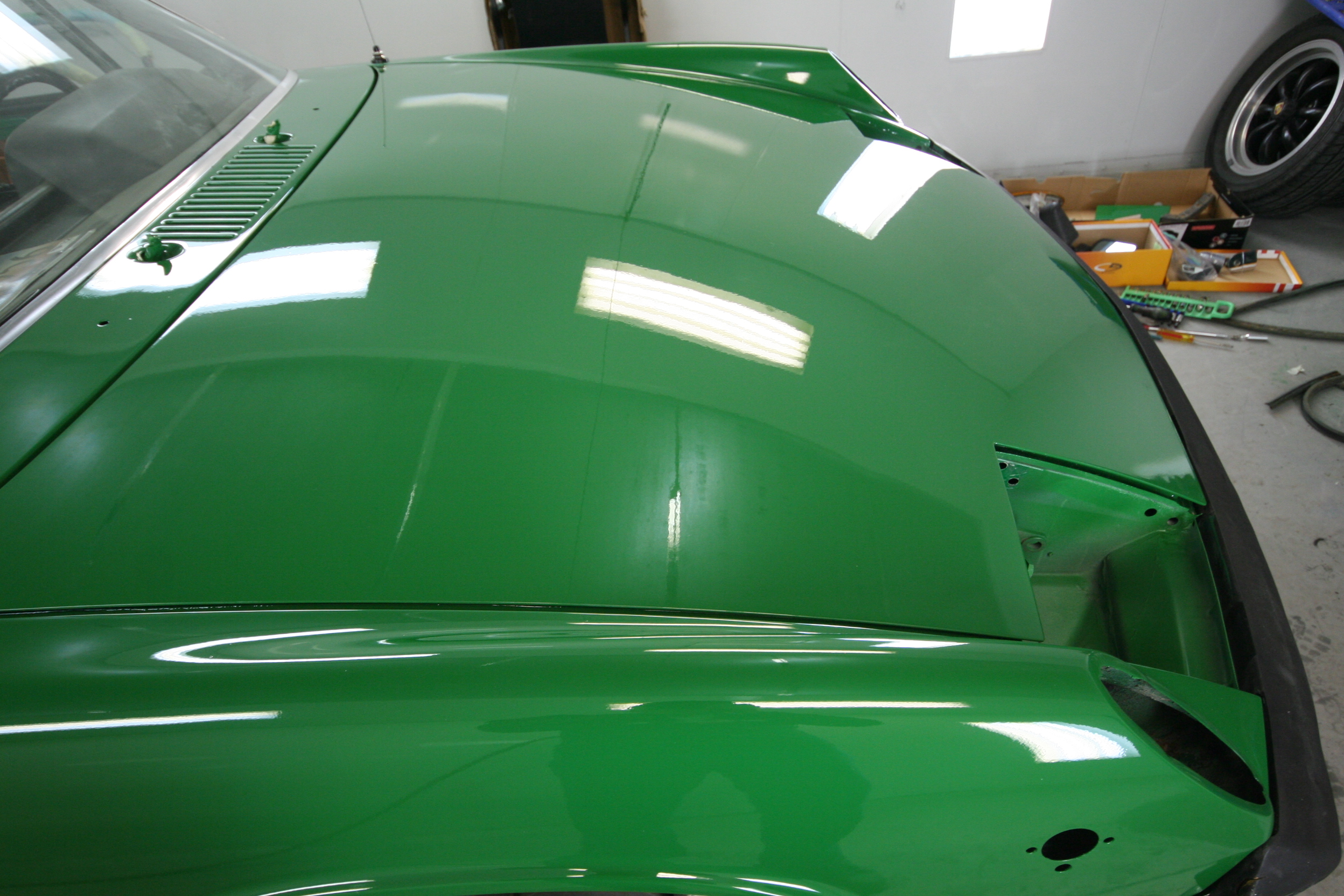

Here's an example of what I'm posting about. This is single stage Nason urethane off the gun, no cut and buff.

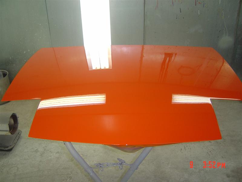

For reference. These two are shop line. The orange is single stage, green is 2 stage

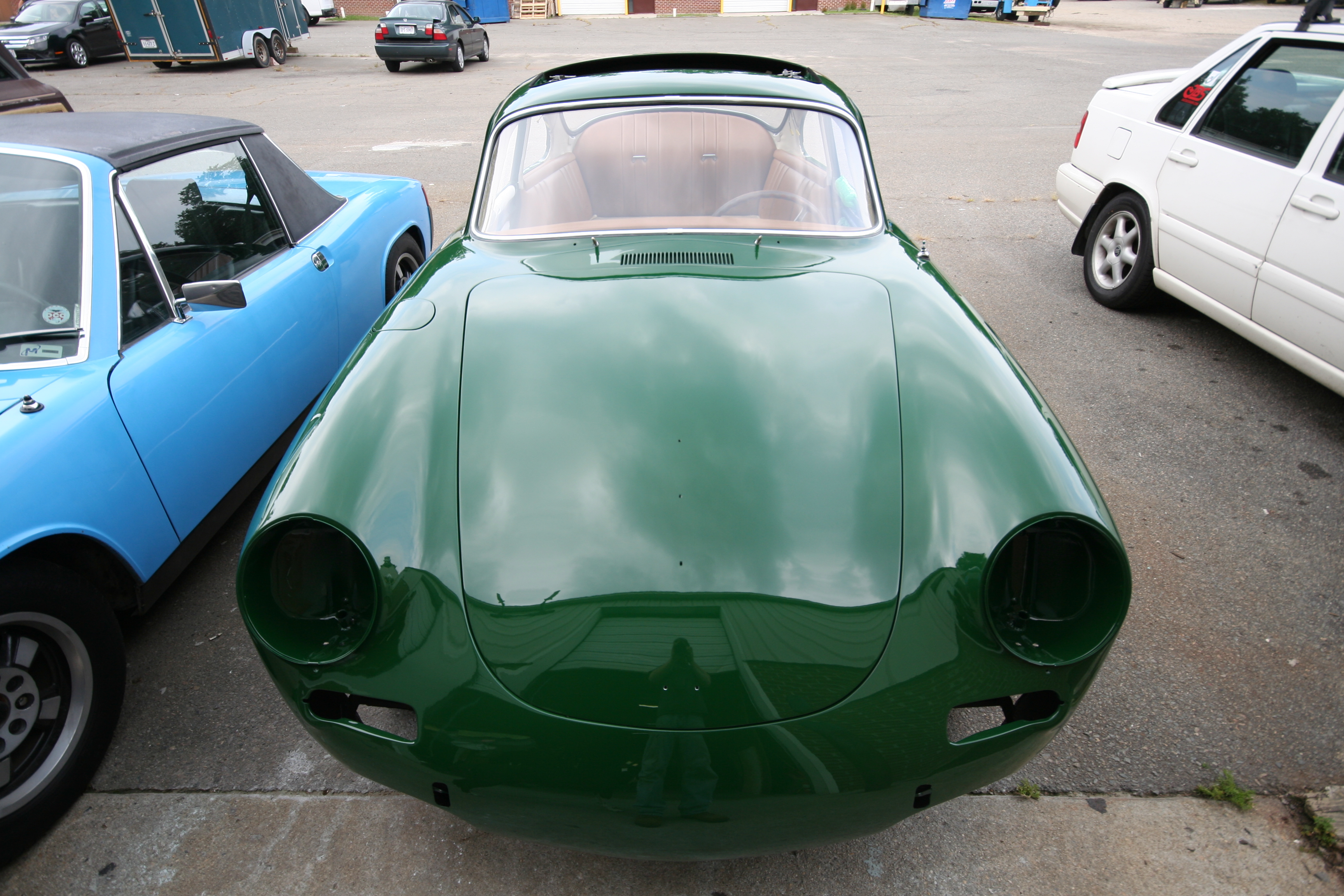

This one is Deltron. The difference is the color will be truer and the solid content is much higher so it takes less coats to get full coverage.

That Deltron 365 looks near factory. Hard car to shoot. Nice work man!

hey guys thank you so much, that is very helpful. hey scotty is that single stage deltron on the 356 or 2 stage?
scotty b
post Sep 8 2013, 12:43 PM
rust free you say ?
Posts: 16,375
Joined: 7-January 05
From: richmond, Va.
Member No.: 3,419
QUOTE(adiokyro @ Sep 8 2013, 07:47 AM) *
2 stage. I usually don't put single on the really nice jobs unless the customer really wants it. If you've ever seen an old car with original paint you probably noticed how all of the edges were worn through and there were thin/bare spots all over the place. ( they call it patina now (IMG:style_emoticons/default/rolleyes.gif) ) that is from single stage paint being buffed, rubbed on etc all these years. 2 stage is more like glass.
