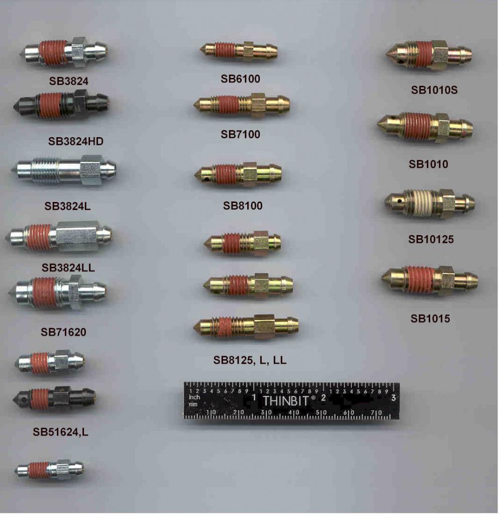

I am trying to bleed my bone dry brake system with a MOTIVE pressure system and a mix of long tube, but since they say you can't use SPEED BLEEDERS with MOTIVE, I want to make sure I am not chasing my tail.
I did bleed each corners twice so far and have some small amount of peddle, maybe 25% or so of normal.
the picture below is a new bleeder and one I pulled out of my jack standed car.

I'm no expert, but those don't look like Speed Bleeders to me.
stugray
post Sep 27 2013, 11:07 AM
Posts: 3,825
Joined: 17-September 09
From: Longmont, CO
Member No.: 10,819
You should be able to blow both ways through a normal bleeder, but only OUT on a speed bleeder.
They have little ball valves in them.

Did you google speedbleeders for a picture?

I tried youtube.
found this in google images
but the bliow method sounds ok for CLEAN ones (IMG:style_emoticons/default/barf.gif)
looks like speed bleeders have a two angle head
wndsnd
post Sep 27 2013, 11:35 AM
You wanted a horse, but got a goat. Nobody wants a goat....
Posts: 2,861
Joined: 12-February 12
From: North Shore, MA
Member No.: 14,124
These are speed bleeders Jim,
I took them out cause I couldn't get them to work.
John
Can't get the blur out but you can see the end fitting.

thanks for the pic : )

oh, and, it seems all the bleeders I have, long and short, are standard - as I can blow thru them both ways - not so tasty.
if I had a set of speed bleeders, I would give them a try for sure.
I did replace the hodge podge of bleeders on my car with all short ones.

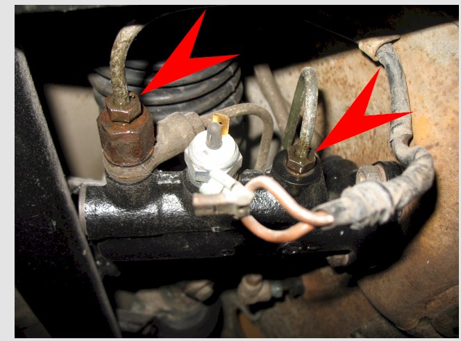

bone dry system wont bleed unless you bench bleed the master...or do it like SLITS said...
The master has no fluid to pressurize yet.

jimkelly
post Sep 27 2013, 02:21 PM
Delaware USA
Posts: 4,969
Joined: 5-August 04
From: Delaware, USA
Member No.: 2,460
I did crack the hard lines to the MC, but only for a minute or two.
I will do the slits trick, longer, to my master asap.
thanks

r_towle
post Sep 27 2013, 02:24 PM
Custom Member
Posts: 24,705
Joined: 9-January 03
From: Taxachusetts
Member No.: 124
QUOTE(jimkelly @ Sep 27 2013, 04:21 PM) *
guess I will do longer.
thanks
jim
you should be able to do the fronts in minutes once the MC is filled up properly.
the rears just suck to do alone.
Rich
jimkelly
post Sep 27 2013, 02:31 PM
Delaware USA
Posts: 4,969
Joined: 5-August 04
From: Delaware, USA
Member No.: 2,460
to be certain - we are talking about cracking these two fittings and letting the drip for an hour or so?
