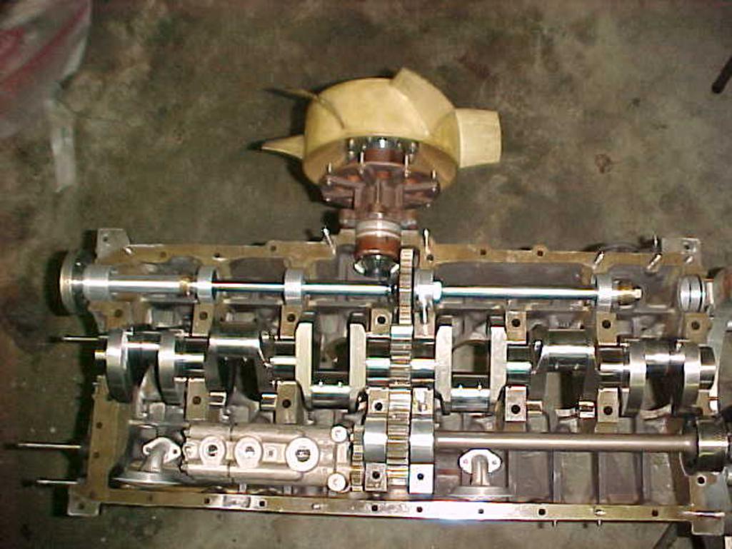

More of the 8-cyl Type IV

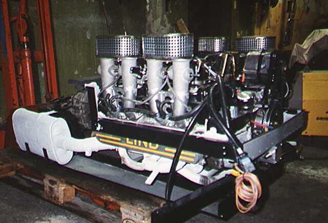

QUOTE(McMark @ Oct 15 2013, 09:43 PM) *
But why Carbs vs MFI or Slide-Valve Injection?

Those aren't carbs. They're ITB fuel injection.

Mark you could turbo the sh!t out of that.

What Lind accomplished hadn't been attempted here in North America.
No doubt the same vibration characteristics were present as Porsche's version.
A masterpiece in ingenuity and fortitude to complete.He speaks Porsche very well.

QUOTE(veekry9 @ Oct 15 2013, 07:38 PM) *
Actually, if you do some reading, that is the very reason why Porsche went to a center driven cooling fan that ran off a 90 degree angle drive on their flat /8 racing engines.
It is quite an eye opener to read about their vibration issues with the long crank and how they went about solving those issues.

I thought the firing order thing was how they finally solved the vibration problems in the 908 motors?
Some of the 908s, at least, used an upright fan that is very similar to the standard 911 one.
When they built the "912" engine (for the 917) they used a center take-off as the only option. The long crank twisted too much to have the take-off at the end.

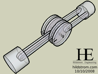

The context,an answer to a question posed to 'engine dorks' about crankenrods.
HD
You could use a knife and fork rod set,the pistons in line,radially.
The advantage of the 'boxer' design is the cancelling of the primary unbalance forces.

'Boxer': Pistons move in opposite directions,a crankpin for each piston.
https://www.youtube.com/watch?v=j_g_K0nyGHQ
180* 'Flat' 12: Pistons move in same direction,sharing the same crankpin,like the V-12.
https://youtu.be/j_g_K0nyGHQ?t=23
https://www.youtube.com/watch?v=j3CkVwtOPX4

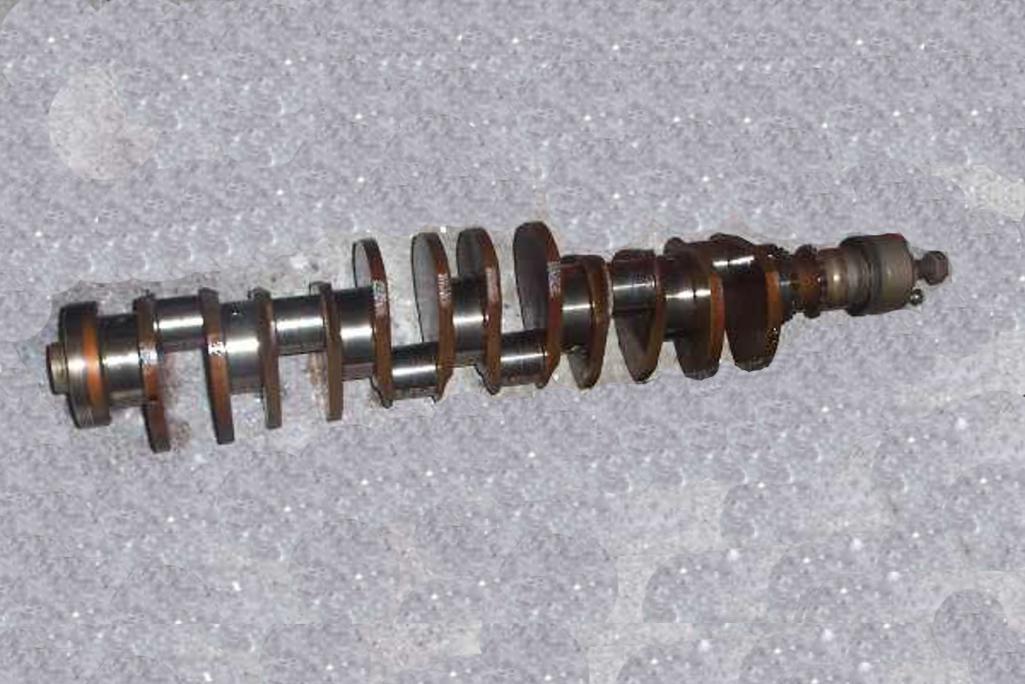

The 911 motor is a 'Boxer',the 917's motor (912) is not.
Because the length of the crank is greater with the boxer configuration.

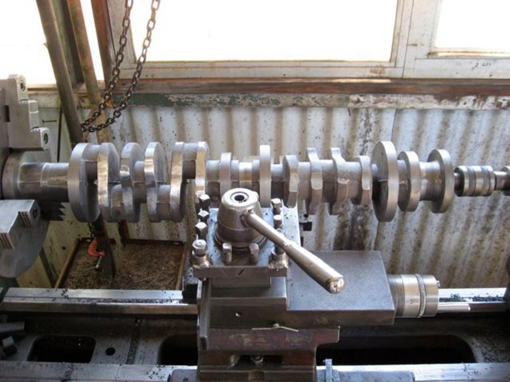

Like the Merlin V12 engine above,the 180* flat engine has 6 crankpins,just like the Boxer Six.
The crank is offset 3" to grind the 6" stroke crank,27L.

RR Merlin crank.Forged,hollow,tubular and light.Sheffield.
http://bbs.homeshopmachinist.net/threads/4...ine-Restoration
http://www.practicalmachinist.com/vb/gener...ankshaft-73615/
The finish anvil below,one of _.

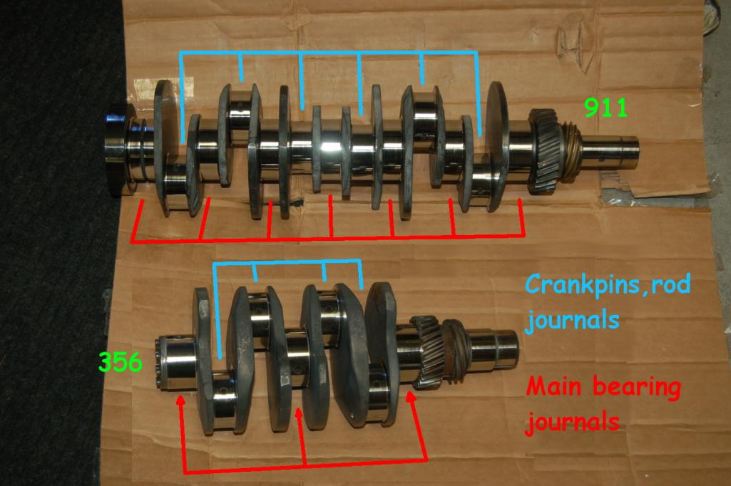

So,yeah,a flat 180-12 engine can have the cylinders inline,the boxer's must be offset.The offset distance is the thickness of the web,rod and journal,if any.
A method to circumvent the offset,with minimal complexity.:

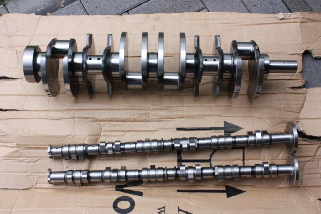

Boxer Cranks
MercedesBenz auto V12
Bmw auto V12
Diamler Benz DB 605 V12 Crank
912 Shafts
https://www.google.ca/webhp?sourceid=chrome...+917+engine+fan
Twin Supra V12 crank,heavy man.

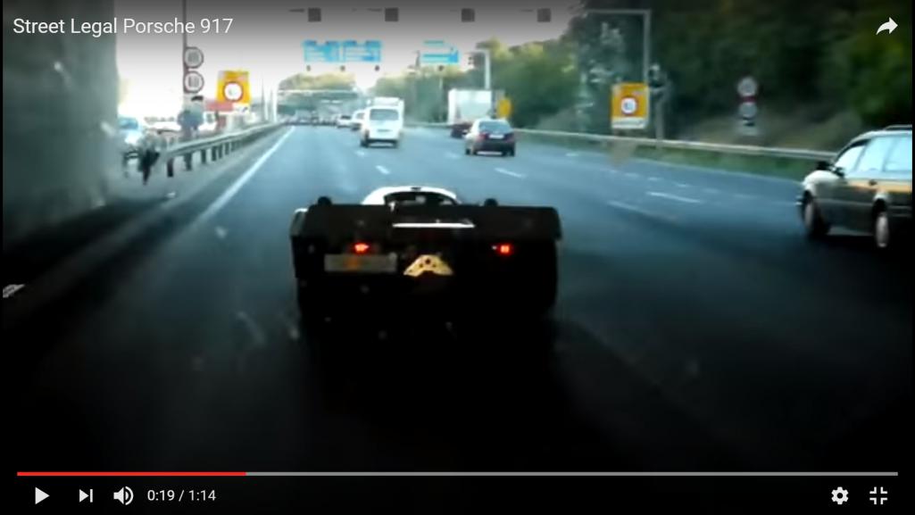

A passion for the 914,shared with others.
https://www.google.ca/webhp?sourceid=chrome...ahn&tbm=vid
http://forums.pelicanparts.com/porsche-911...-flat-12-a.html
http://gtspirit.com/2013/12/29/remarkable-...al-porsche-917/
911+911=flat12!

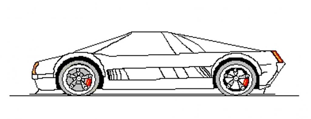

A MS Paint drawing from the '90s,to show the kids how to use the pc,called it 'Veloce'.
