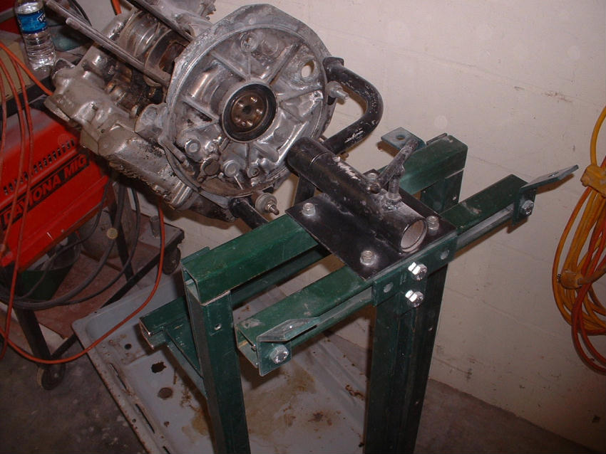

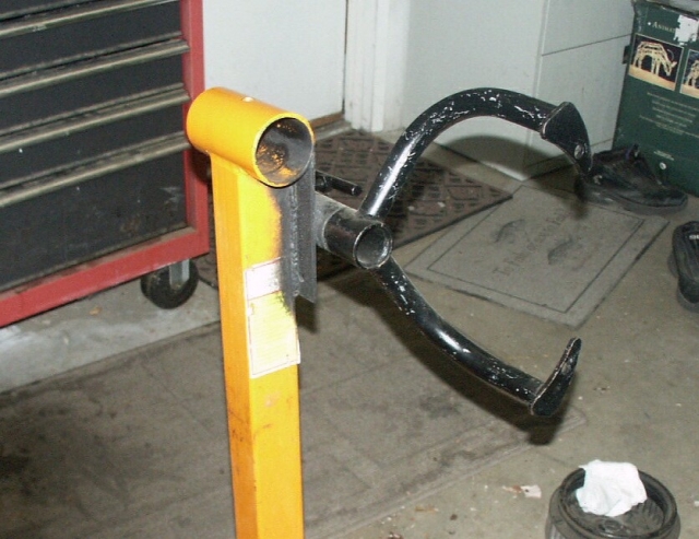

We welded the bench stand on the v/8 stand . works good, kills 2 birds with stone. see pics
Attached image(s) ![]() |
bernbomb914 |
#5
one of the oldest Farts on this board ![]() ![]() ![]() Group: Benefactors Posts: 1,873 Joined: 29-December 02 From: Temecula, CA Member No.: 36 ![]() ![]() |

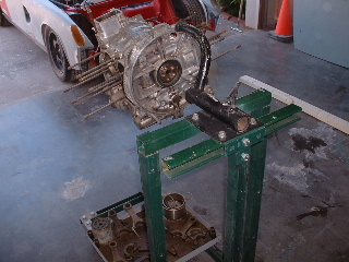

aa

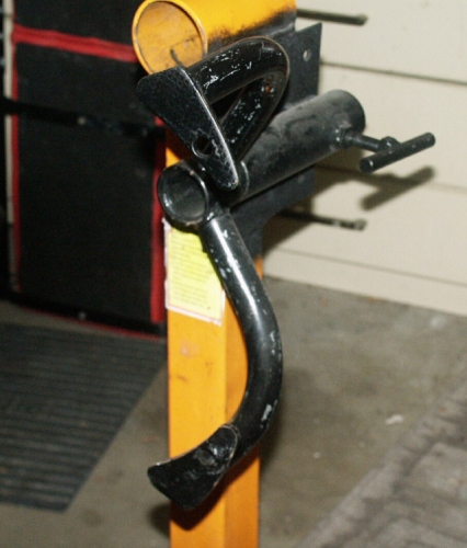

Not really practical for splitting the case and doing engine internals but has worked great for everything that I have done. Had the P&Cs off. Can be raised and lowered, rolls around. I can use it to take the engine out and put it in as well. I think it is actually a transmission stand.

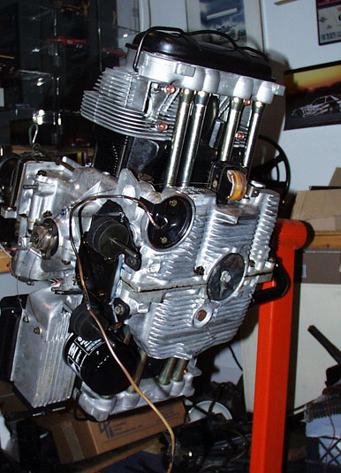

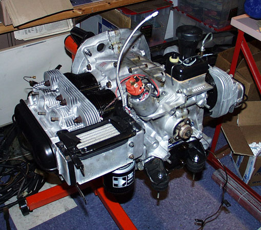

I used a JC Whitney engine stand with a VW addaptor:
newdeal2 |
#8
Unregistered ![]() |
Here's a picture. It cost about $100.00:
newdeal2 |
#9
You can move it around and rotate the case for easy access.

newdeal...that is one pretty engine!
newdeal2 |
#11
Thanks...it's my first re build. Jake has me a little concerned but so far it's running pretty good (IMG:http://www.914world.com/bbs2/html/emoticons/wink.gif)
I kept it basically "stock" 94 euro pistons/ cylinders and a Webcam/lifter set and added a type 1 oil pump. Not sure I picked the best pistons [AA] but I had a very tight budget. I had the heads and crank done by a pro along with an align bore and new oil galley plugs [tapped in that is]. Hope it breaks in good. If not I just may do it again. It was a fun job. |

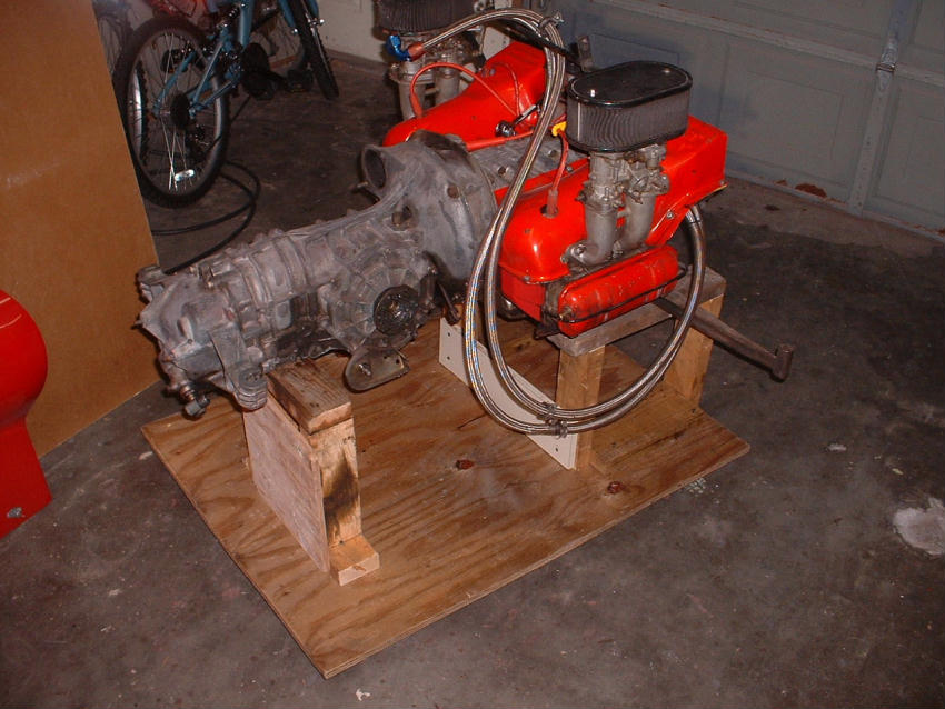

I have a true engine stand but this is my engine/tranny stand (IMG:http://www.914world.com/bbs2/html/emoticons/biggrin.gif)

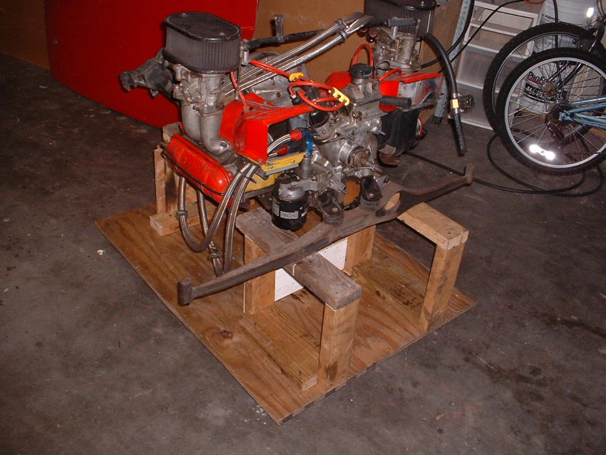

Its made out of some left over plywood. (its the plywood I had on my windows during the hurricanes (IMG:http://www.914world.com/bbs2/html/emoticons/biggrin.gif) )
It has casters under it. Attached thumbnail(s) ![]() |

Where do you get this VW Workbench Adaptor? i've Been looking for one, and I currently just have my engine on a V8 stand, but it's holding both case half's, so I can't split it yet.
Eric |
bernbomb914 |
#19
I bought mine on ebay $20.00 they are in catologs for 29.95. any VW type will work.
Bernie |
Dr Evil |
#20
Send me your transmission! ![]() ![]() ![]() ![]() ![]() ![]() ![]() ![]() ![]() ![]() ![]() ![]() ![]() ![]() ![]() Group: Members Posts: 23,041 Joined: 21-November 03 From: Loveland, OH 45140 Member No.: 1,372 Region Association: MidAtlantic Region ![]() ![]() |
If you can wait till after new years when I can ship it, you can have mine for $20 + shipping. It is the same type that Bernie has welded onto the other stand.
