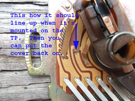

There is an idle circuit that only activates in a single position.
The TPS is designed for many cars and many throttle bodies.
There is ONE way to mount it...its really not adjustable once you mount it correctly.
The pic is as mounted with the throttle body closed.
You can pull the throttle body with the TPS attached and set it up on the bench...no meter needed.
Use the picture below.

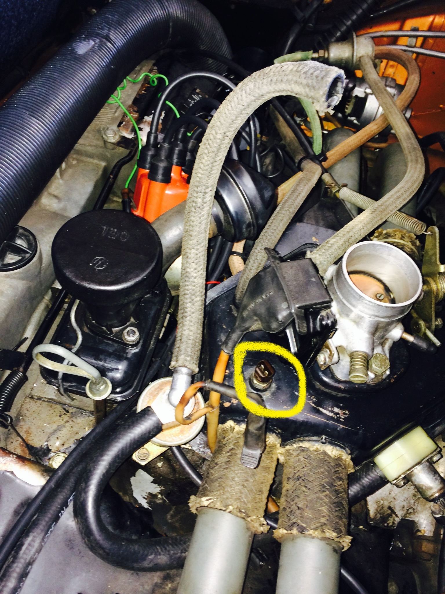

Thanks for the site link. It is indeed a great site. Here is a pic of the electrical plug on the plenum that is disconnected. If this is the Air Intake Temp Sensor, are these things available?
....and yes, I'm embarrassed that my engine is worn looking, but it is 38 years old!
Thanks,
MikeAttached Image

Java2570
post Nov 21 2013, 01:27 PM
Posts: 649
Joined: 7-May 11
From: Fishers, IN
Member No.: 13,035
In reference to your engine photo, trust me we've all seen much worse. That is the air intake temp sensor and I'm sure someone will have a good one if you post a WTB ad in classifieds here. I'm guessing that it's an issue in your wiring that's causing your problems. The wires and connectors all get pretty baked after all those years and Jeff Bowlsby makes great replacement harnesses for our cars. I believe the Anders
link has the procedure for testing that sensor to determine whether it's ok or not so you may want to do
that before buying another. For wiring, a quick thing to do is to check and clean all your connections and grounds and see if that improves anything.
