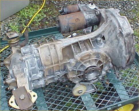

Trekkor
post Dec 28 2004, 01:49 PM
I do things...
Posts: 7,809
Joined: 2-December 03
From: Napa, Ca
Member No.: 1,413
pretty clean (IMG:http://www.914world.com/bbs2/html/emoticons/smile.gif)
KT
Mueller
post Dec 28 2004, 01:58 PM
914 Freak!
Posts: 17,155
Joined: 4-January 03
From: Antioch, CA
Member No.: 87
pretty clean
clean = yes (good job, they can be a PITA to clean)
pretty = no (IMG:http://www.914world.com/bbs2/html/emoticons/smile.gif)
it's too bad the transmissions normally look so beat up....I'd like to powder coat one...sure would make cleaning it a lot easier
