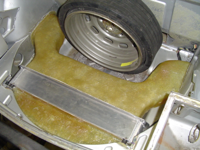

The oil cooler is a rear mount under the car on the passenger side rear. I made some duct work and its almost vertical to catch the most air as possible.

you really need a front cooler to improve efficiency on the track
I know Chris at Tangerine and others have wonderful rear cooler systems that work... I'm not taking anything away from them
but frontal air is going to be more efficient
and I have always found front coolers to be more effective
(I did put a rear cooler into one car, and was never pleased with it's results)

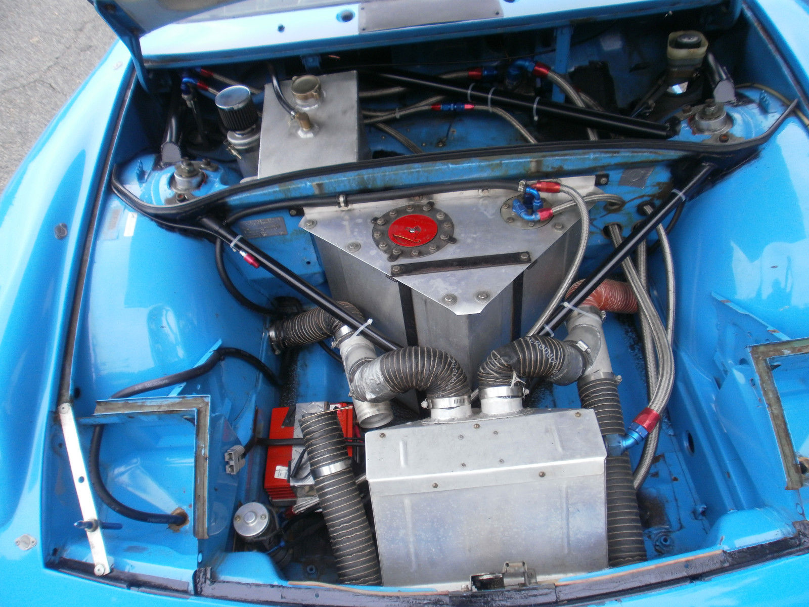

When I had my 4 Cylinder Track car I Always ran the Accusump and had a Front Cooler, but my Temps were always High. I think it is because Sebring is such a Long Track & the RPMs are always High.
As Far as Routing the Air from the Front Cooler, you can run it out the Front Wheel Wells
carr914

Here's another Duct to Wheel Well
brant
post Dec 18 2013, 07:27 AM
Posts: 12,295
From: Colorado
Member No.: 47
The exit must be larger or less restrictive than the intake
I changed my front cooler exit twice on an old 914 race car. Each time I hanged to a less restrictive exit I dropped another 10-15 degrees of oil temp. This was with the same cooler on the same car and same motor.
The tubes to the wheel wells are to restrictive. Air won't flow through the cooler with that much resistance
