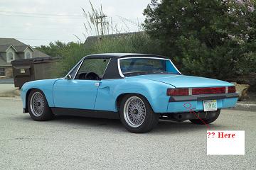

Didn't know where teh sotkc locations we're as both bumpers are f/g so no holes. We can fix that (IMG:http://www.914world.com/bbs2/html/emoticons/sawzall-smiley.gif)
So the rear one would be about here ??
Root_Werks
post Jan 10 2005, 03:07 PM
Village Idiot
Posts: 9,066
Joined: 25-May 04
From: About 15NM from Canada
Member No.: 2,105
Yep, around there somewhere. (IMG:http://www.914world.com/bbs2/html/emoticons/biggrin.gif)

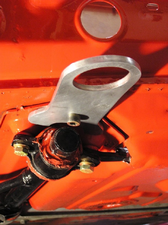

Here is my home-made front one:

FWIW the rear hook is not terribly strong; er maybe "strong" (it's forged) but it's brittle. I broke mine off in a little trailer unloading incident. I tried to extricate the shank with a bolt extractor but no dice.
In the front I got the part somebody here was selling a while back and mounted it as I saw on Milt's former car "Manfred", now Z's. Bolted up to the tub down under the right headlight. That works fine...unfortunately I've had to use it at Willow. (IMG:http://www.914world.com/bbs2/html/emoticons/sad.gif)

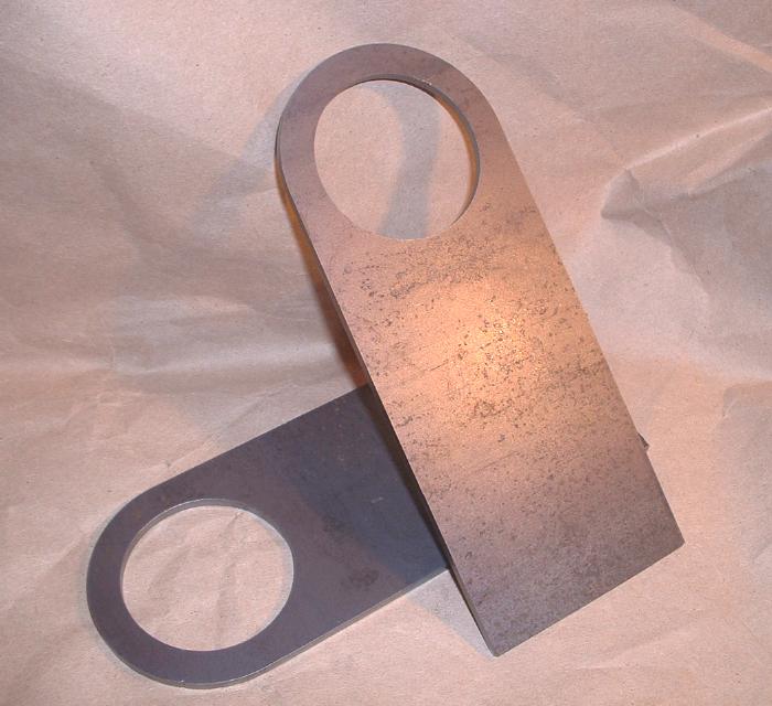

I have one pair of these left. I believe Trevor has them spoken for. They're $18.00 a pair plus shipping. Ron Szymanski (RON S.) manufactured a batch and we sold through them. I suppose if there's enough interest more could be made...
Eric_Shea
post Jan 11 2005, 12:09 PM
PMB Performance
Posts: 19,304
Joined: 3-September 03
From: Salt Lake City, UT
Member No.: 1,110
Trev,
I sent you an e-mail with the shipping amount etc. I'm using these on mine with FG bumpers. I will put a 90 deg. bend in it and cut an exit slot under the faux rubber cap, around the inside tie-in point on the headlight bucket area. They will be mounted horizontally like Brants but higher up on the tub. If you get yourself in the kitty-litter you may want it higher. For a skilled driver like Brant, this probably isn't a problem (IMG:http://www.914world.com/bbs2/html/emoticons/driving.gif) (IMG:http://www.914world.com/bbs2/html/emoticons/wink.gif)

On the rear, yes its just a mount into sheetmetal. The metal is somewhat reinforced, but not as strong as a suspension point...
my choice was to not add anything to a suspension point in that I didn't want the weight.
