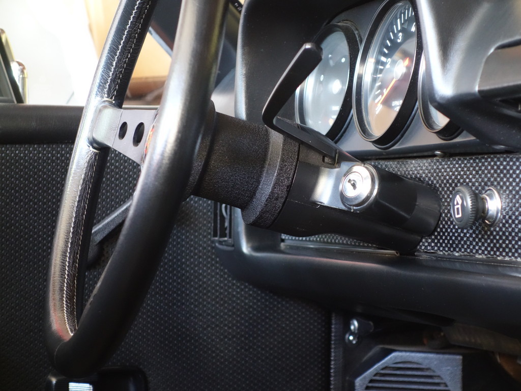

i just added a picture of my steering wheel

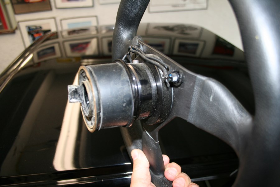

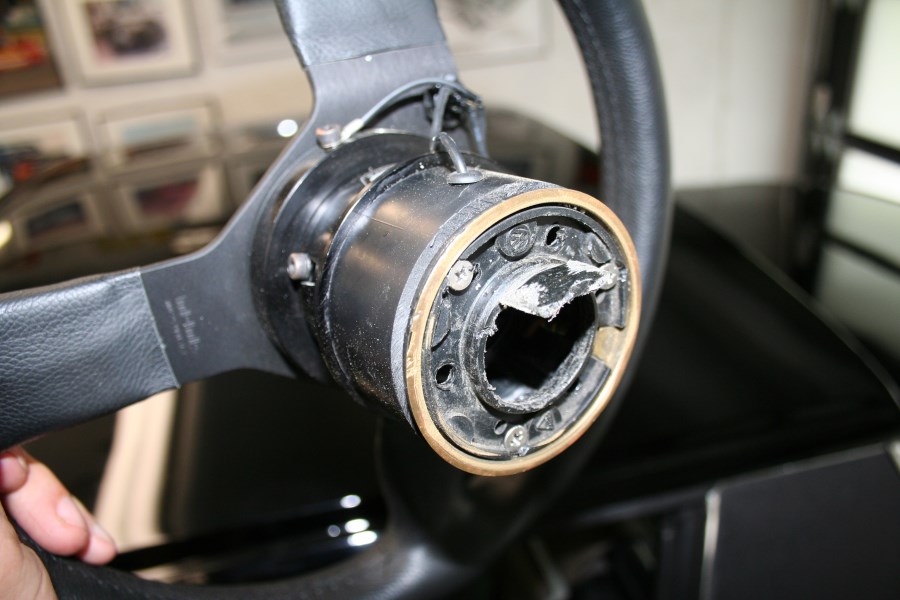

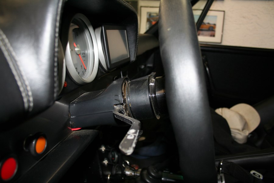

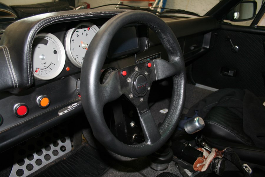

My after market wheel with quick disconnect and pvc pipe extension for turn signal canceling.

This is a Momo hub adapter. There really isn't much to mess up.
