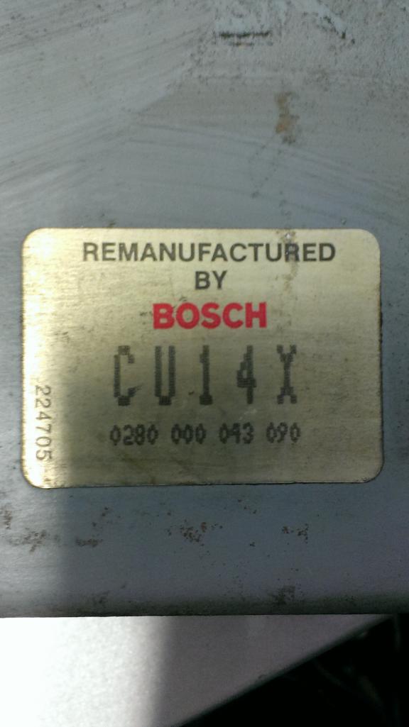

I have a similar question on my '74 2.0.
The P/N on my ECU match those in the table from link. However, there is a three digit number (090) after the part number. Does anybody know what the 090 represents ?
