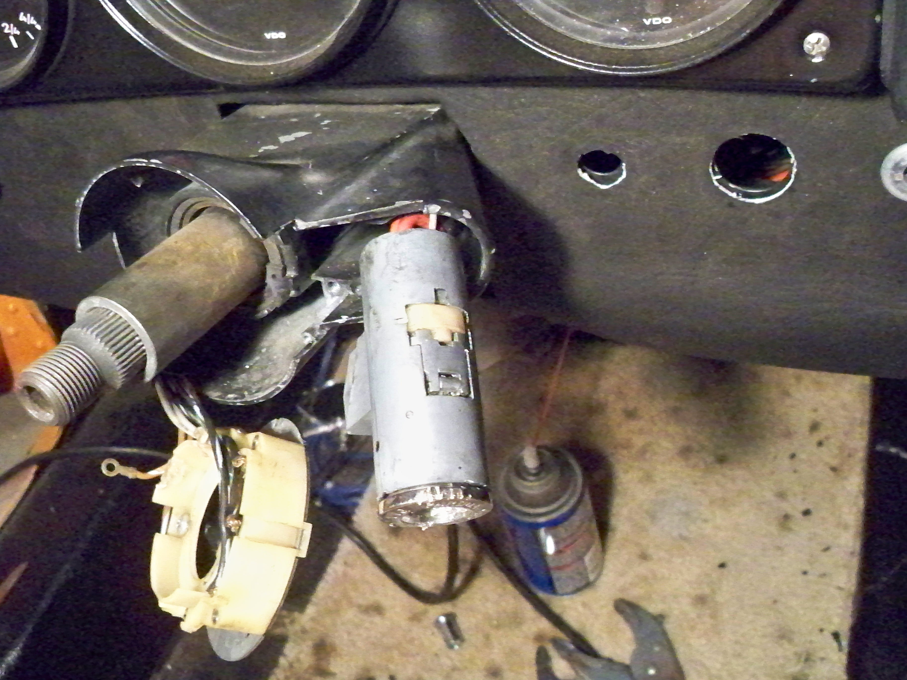

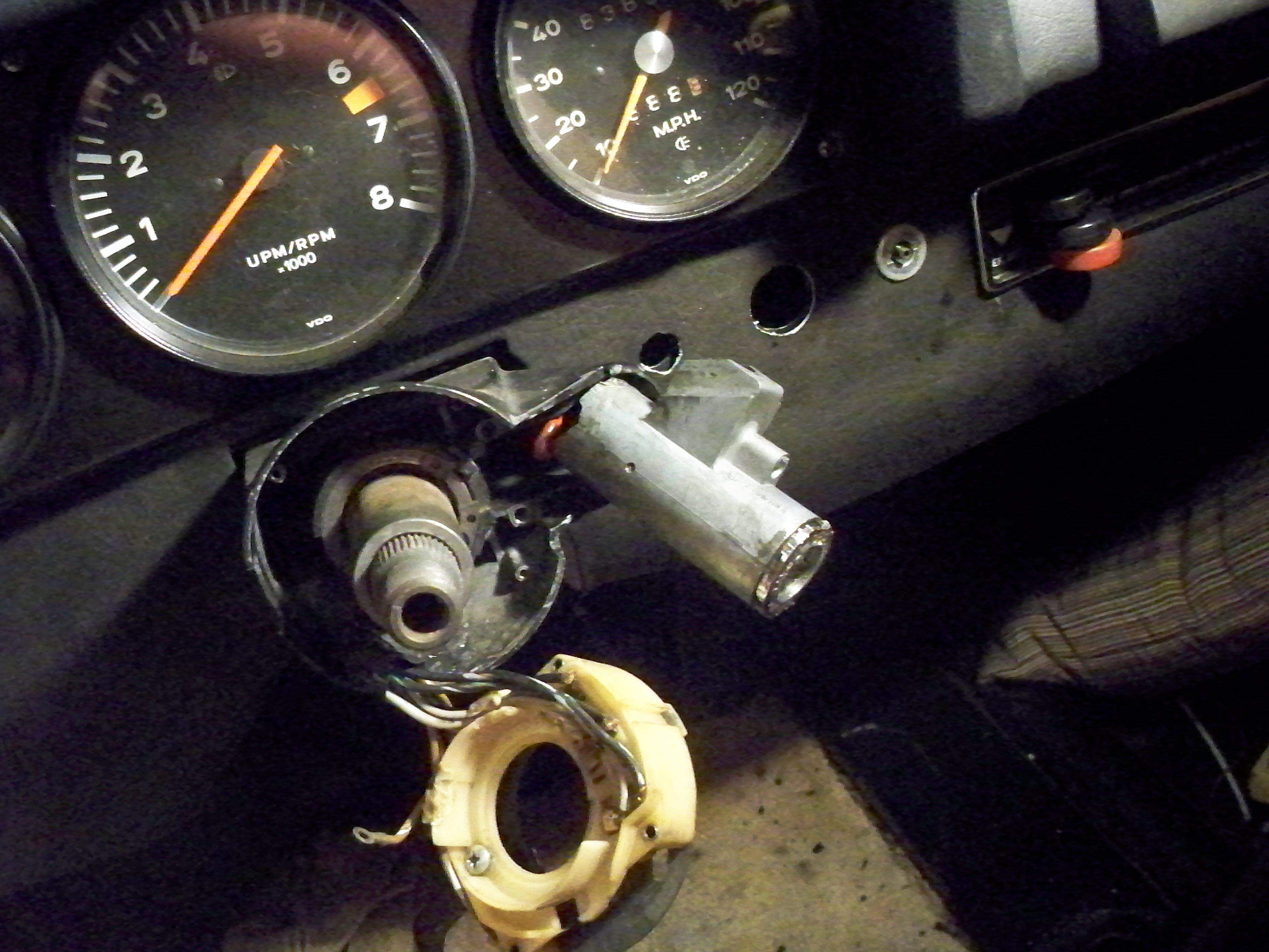

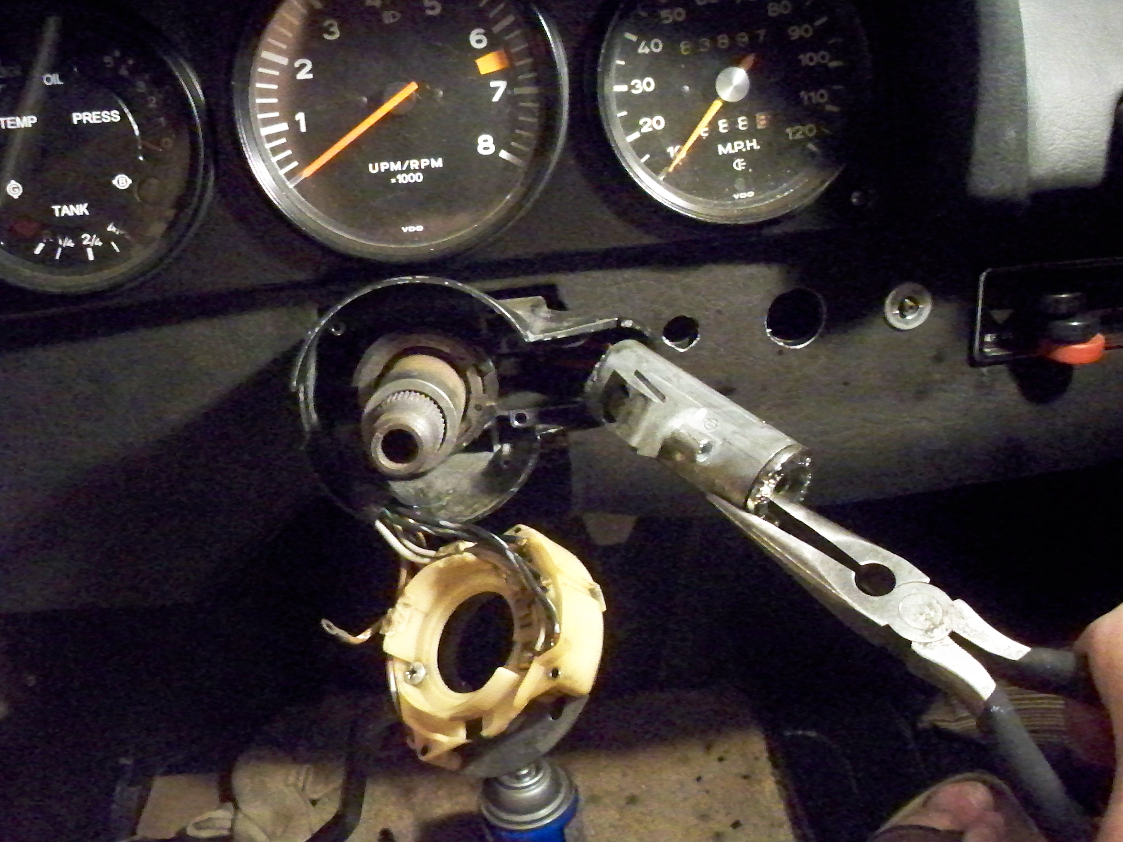

I figured I just didn't know the secret handshake. So with the PP article and the drill suggestion I got out my weapon of cylinder destruction and you can see the results. In my mind I was drilling thru the DAPO's hand to get to the cylinder.
This '70 is different than the later versions--it doesn't plug in from the back. You can see the tiny holding screw on one side...
...and I guess I have to get the switch out from the other side.
And I still need to get the rest of the cylinder out. I'll get back after it tomorrow but if anybody knows these early ones and can point me in the right direction to finish the job, I'd appreciate it. Thanks.

There is a small slotted set screw on the side of the cylinder towards the bottom of the cylinder. Unscrew that and then the lower electrical portion with wiring can be separated from the cylinder

Remove the set screw that holds in the lower electrical part.
I think I can see it in the picture.
Replacement switches are hard to find. I think VW beetles of the same year had the same switch.
The Pelican article does not apply to the 70-71 cars.
