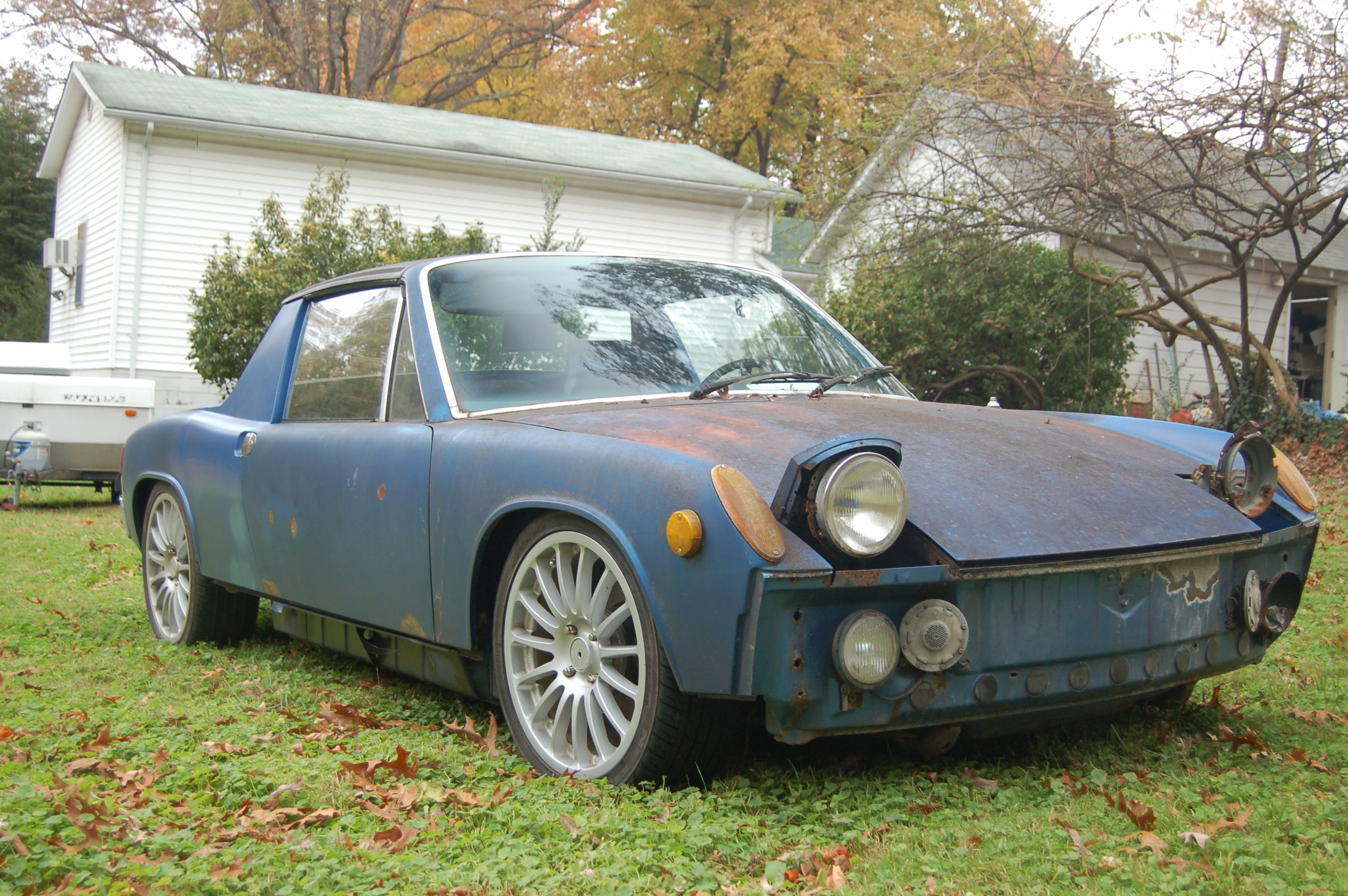

My car does have 17" wheels on it, don't know the offset though. I will be taking a look at the gap between the ball joint and wheel tomorrow. And again the only thing I hope to get out of this is some front suspension travel. So Dave why would this potentially cause worse bump steer?
And my car does look slightly better now than in this photo this was just after getting done with some major rust repair 1 1/2 yrs ago.
