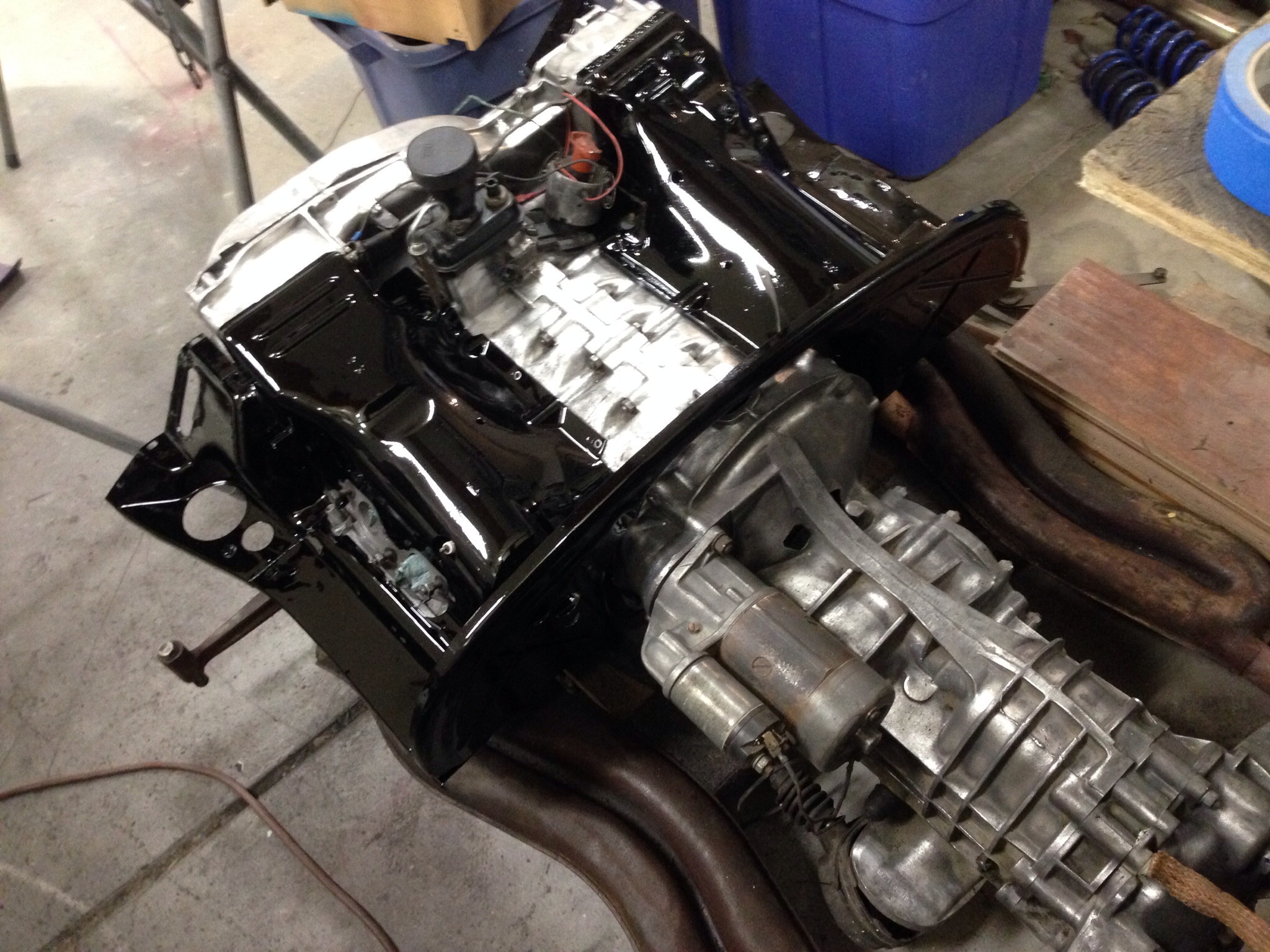

I have my engine out for a bear tub restoration. I am reassembling everything and almost ready to put the engine back in.
As I was cleaning things up replacing the tube seals and getting ready to adjust the valves I found these threaded sleeves in my spark plug holes. Attached Image Attached Image
Looks like a PO was a DA?
Did they strip all of the spark plug threads and use threaded inserts?
I probably wouldn't have even noticed but they are loose and partially back out when I took out the plugs.
They are at different depths now but do they bottom out when the plug is tight?
I can't tell because the base of the plug covers the sleeve when the plugs are in place.
I really don't want to take the heads off. I had no issues prior.
If it ain't broke don't fix it?
Or am I risking a bigger problem?

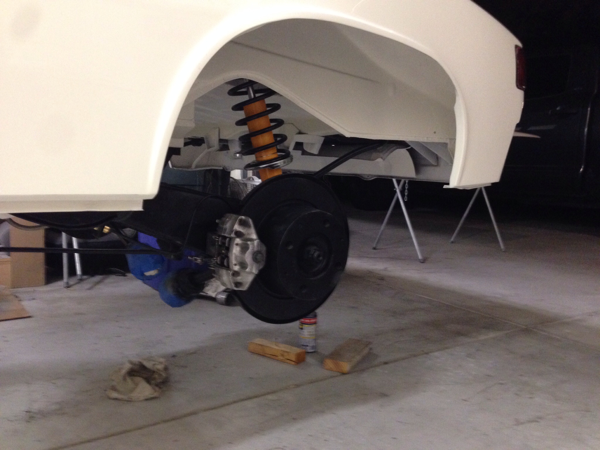

Thanks.
I pulled it apart in November and was trying to make the wcr this weekend. I didn't quite make it.
I stripped it to bare metal, repaired a few bad rust areas and painted it in my garage
It is coming together better than I expected. (IMG:style_emoticons/default/piratenanner.gif)
Attached Image Attached ImageAttached ImageAttached Image

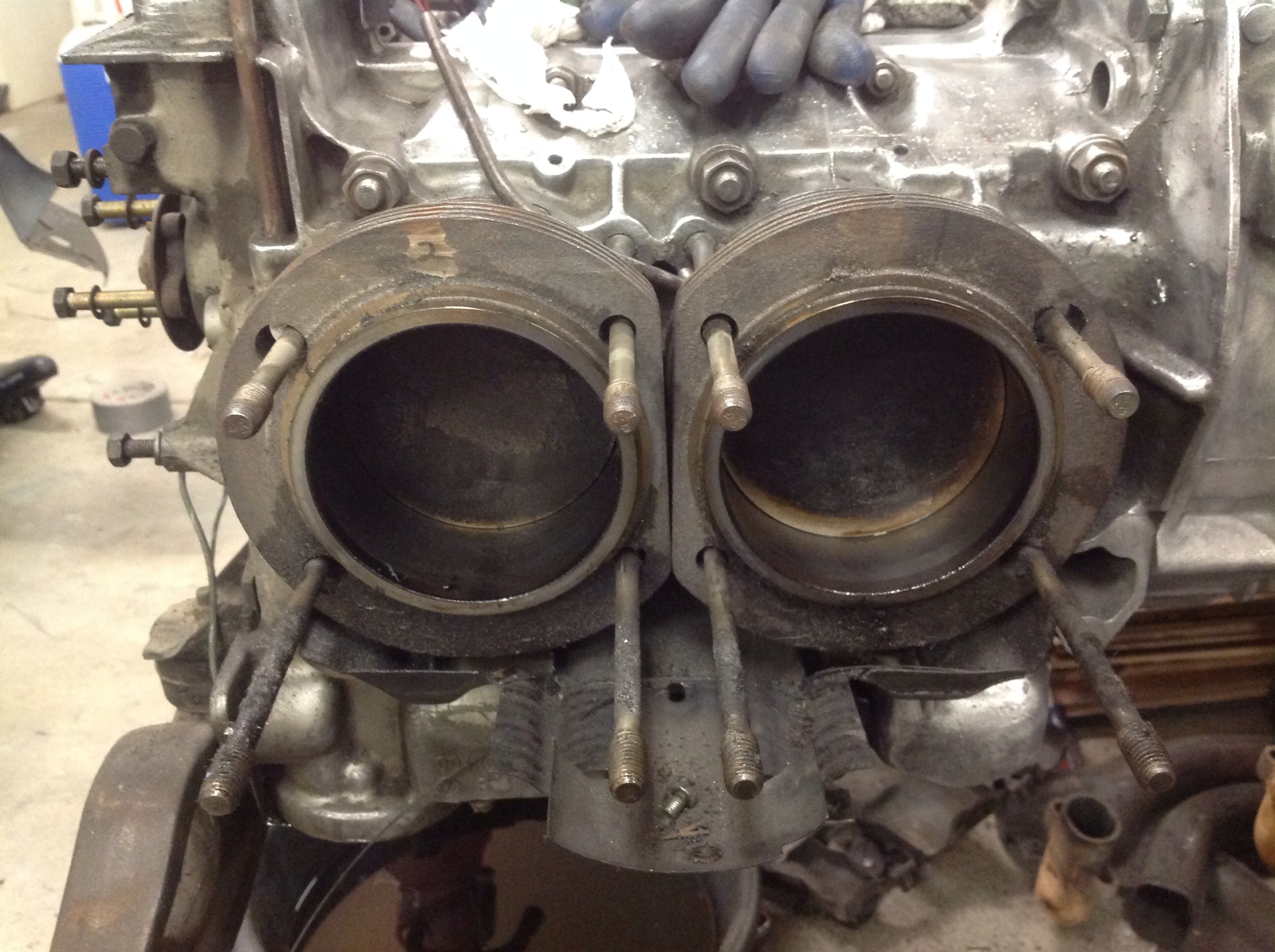

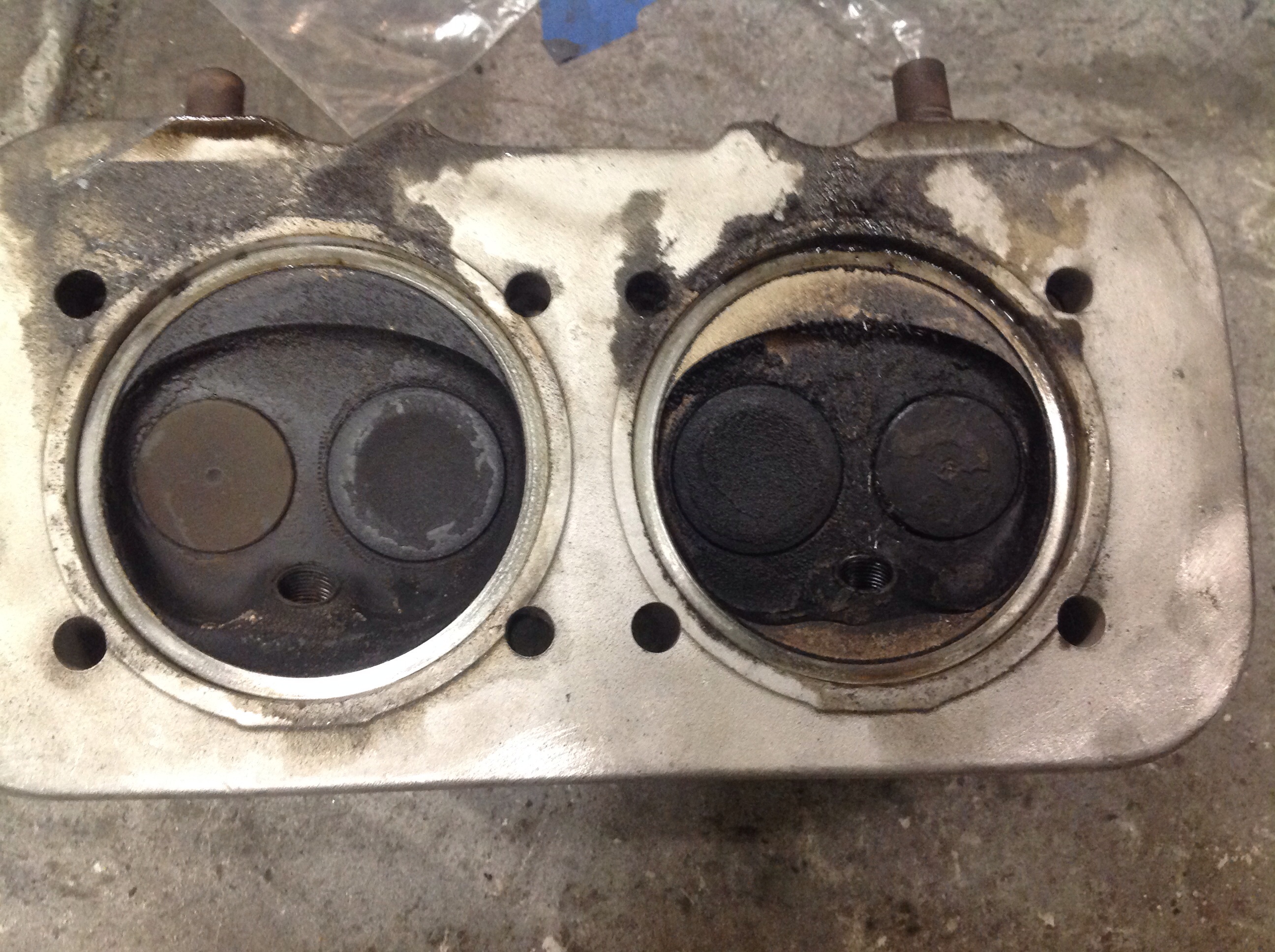

Here is what I found. Do you see anything else wrong here? I will clean them up and inspect further. One combustion chamber has a lot more carbon/soot.
Should I pull the cylinders?
Should I think about new rings?
This has been apart before. The cylinders are numbered with a sharpie.
Any Attached Image Attached Image
