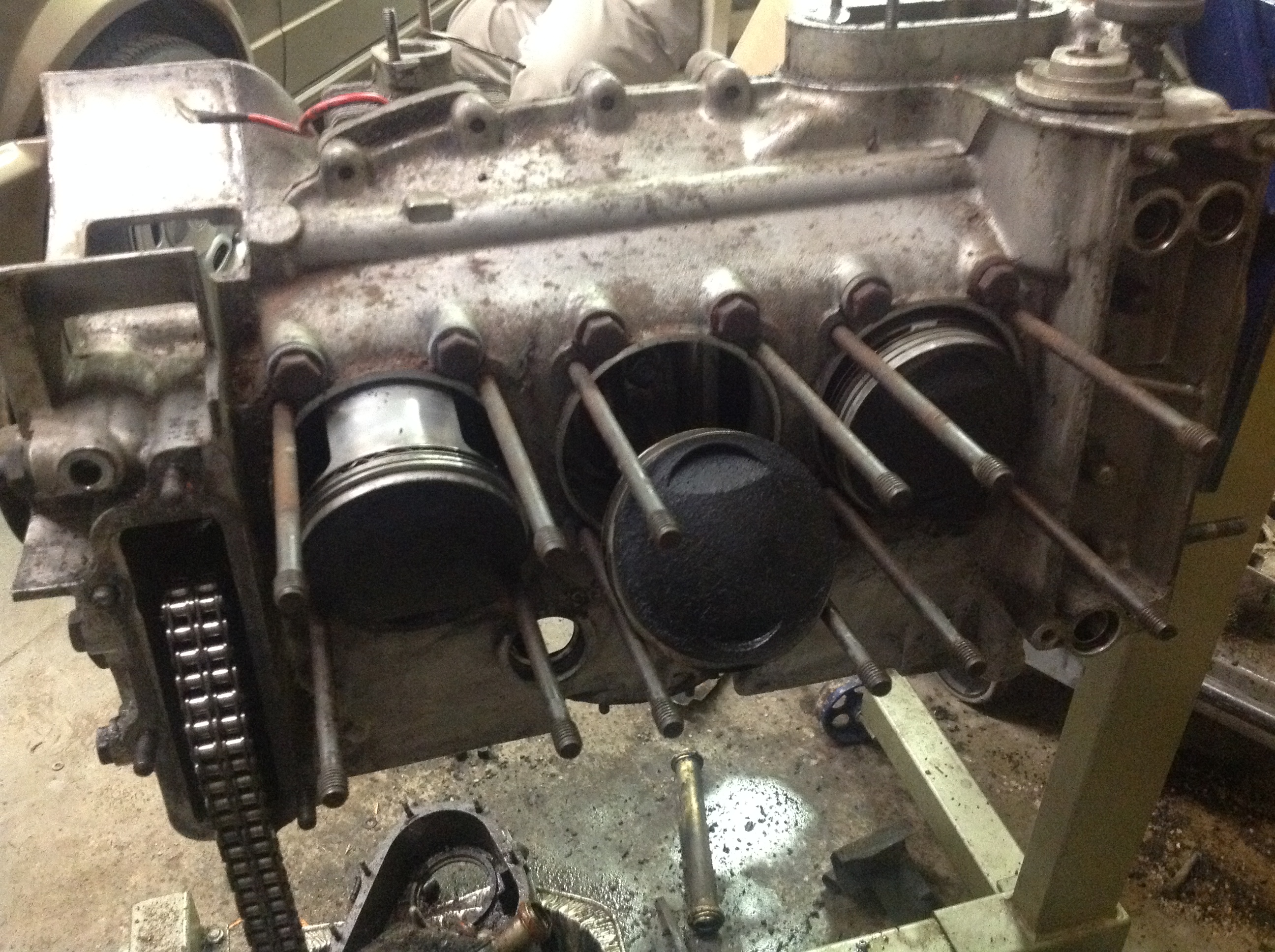

Pulling apart that Aluminum case 2.0 motor in anticipating to sell it and cant seem to get one of the heads off.
Motor has been sitting for 20 plus years and rotates freely.
4 heads came off with a little more than a ketchup bottle thump.
1 head came off with the cylinder attached
The other one, wont seem to budge. Made sure all washers were removed. been soaking with PB Blaster for a couple of days
BTW: motor had been sitting for several years and a mouse had made a nest on top of that particular cylinder.
Hence - Mouse motor...
Any suggestions? (IMG:style_emoticons/default/confused24.gif)

5 of 6 cylinders heads off
3 cylinders off
