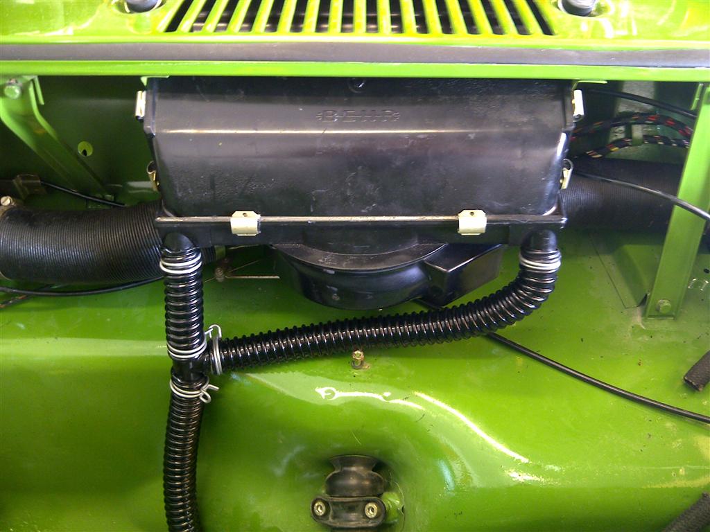

That is what I used. This is a picture (only one had) of the same hose up front.

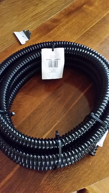

Grabbed a tape measure before I left.
