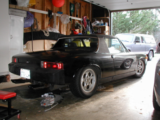

post Jul 16 2014, 06:40 PM
V-8 madness
Posts: 764
Joined: 27-December 06
From: Port Orchard, WA
Member No.: 7,391
I'm running Falken 215/60 x 15 all the way around. The wheels are 911 SC phone dials, 15 x 6 on front and 15 x 7 rears. As I understand most 911SCs had the 16" Fuchs, but that was an option and the phone dials were standard.
I did stretch the rears with a bat to get them to fit, but it's a nice set up. When I get new tires I may go 205s up front, I've been told the 215 is a little wide for a 6" rim.

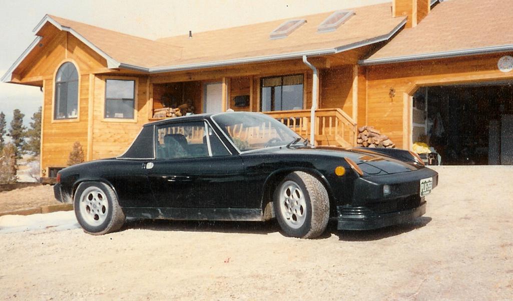

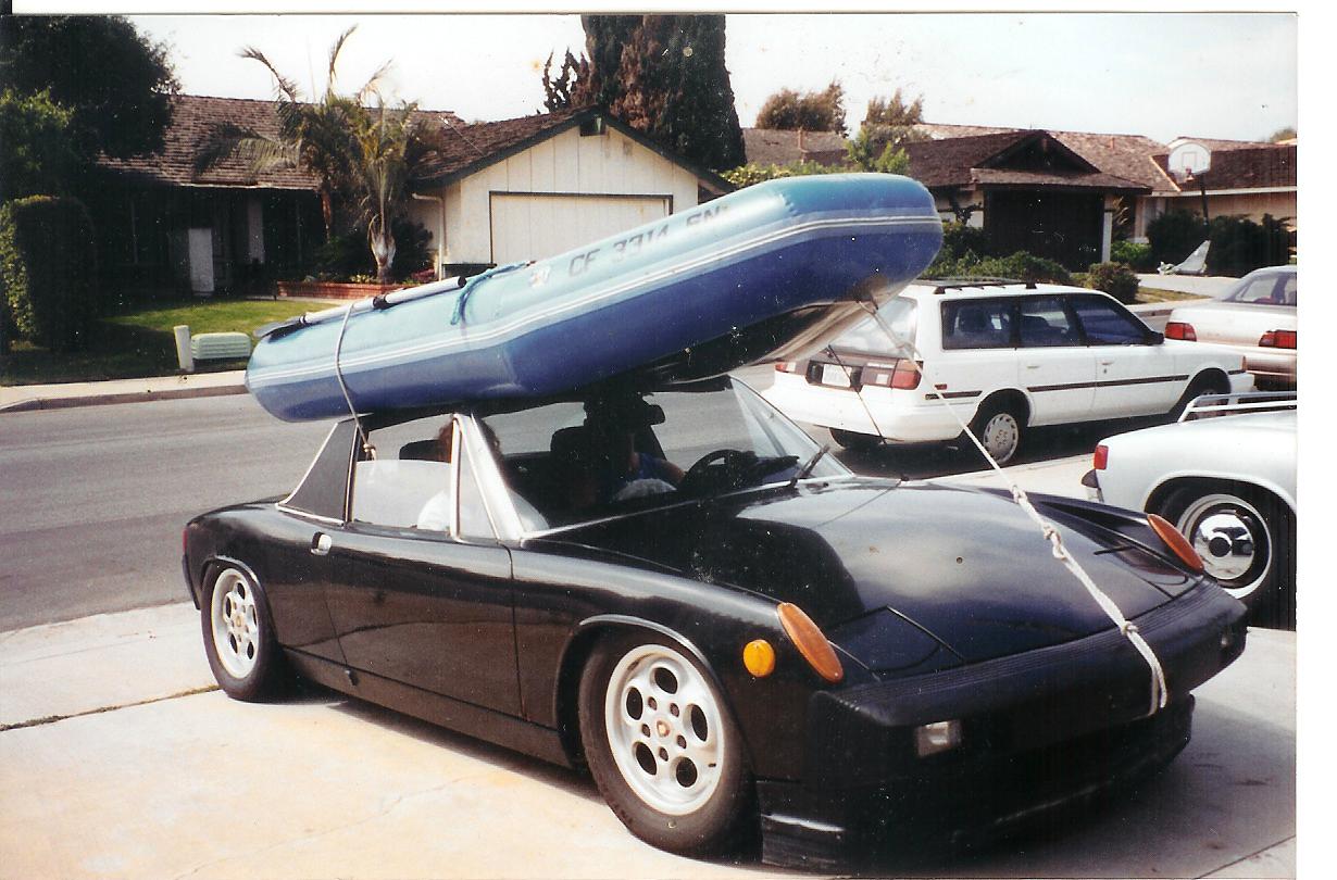

Eric_Shea
post Jul 16 2014, 07:09 PM
PMB Performance
Posts: 19,304
Joined: 3-September 03
From: Salt Lake City, UT
Member No.: 1,110
Your future is calling...
(IMG:http://www.914world.com/bbs2/uploads_offsite/fbcdn-sphotos-e-a.akamaihd.net-1110-1405559348.1.jpg)
(IMG:http://www.914world.com/bbs2/uploads_offsite/scontent-b-sjc.xx.fbcdn.net-1110-1405559349.2.jpg)

QUOTE(Bruce Hinds @ Jul 16 2014, 05:40 PM) *
Hot damn that setup looks sweet, especially at the rear. And I do need to repaint both sides of my car again... (IMG:style_emoticons/default/idea.gif) (IMG:style_emoticons/default/smash.gif)
This is EXACTLY what I was looking for. If you've got any more photos from other angles, please don't be shy. I've been trying to find the right setup for years, and this might be it for me. Thanks!!!!

Bruce Hinds
post Feb 7 2016, 12:17 PM
V-8 madness
Posts: 764
Member No.: 7,391
215/60 x 15 phone dials, 6" up front and 7" in rear. Rear lips stretched and rolled, poorly cracking the paint.
