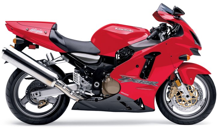

Just got back from the local cycle shop...found out my new throttle bodies came off an '02 or '03 Kawasaki Ninja ZX-12R...rated at 165 horsepower (IMG:http://www.914world.com/bbs2/html/emoticons/smile.gif)
Who knows, the fuel injectors might just work on my new motor afterall....
