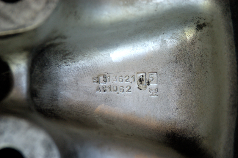

and there should be a stamp of a fox head on the inside of a real fuch.

You dont have a photo of the fox head do you? That may heal him know what to look for.

This is what it looks like (bottom center) on a 5 lug 911 Fuchs wheel.
