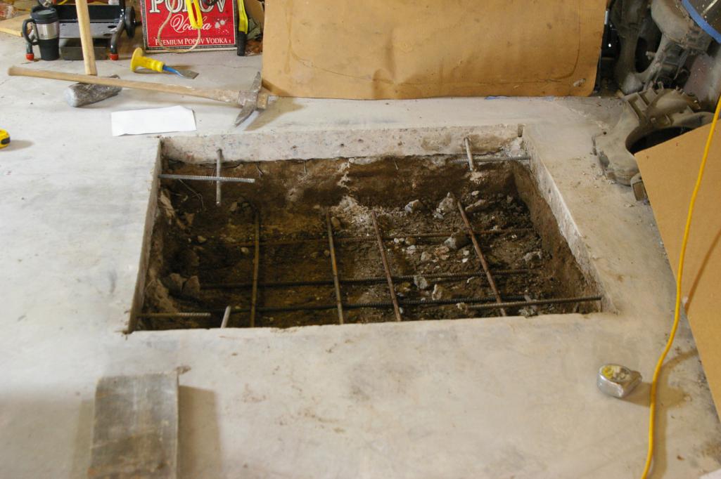

Did you have to reinforce/ rep our the garage floor to a deeper than standard floor slab to mount the lifts?. It looks like there is a different pour by the stands. How high can you get the car off the ground?
I only have a 9 foot ceiling in my garage, but I'd love to get a lift like this.

QUOTE(GeorgeRud @ Aug 2 2014, 12:41 PM) *
Yep, I cut out a 4' x 4' pad and dug it out to 10" deep and pinned it to the existing slab, poured 4000 psi concrete. About 48" lift
About 9' to the joists

Nice set-up Paul, love the concrete work!!!

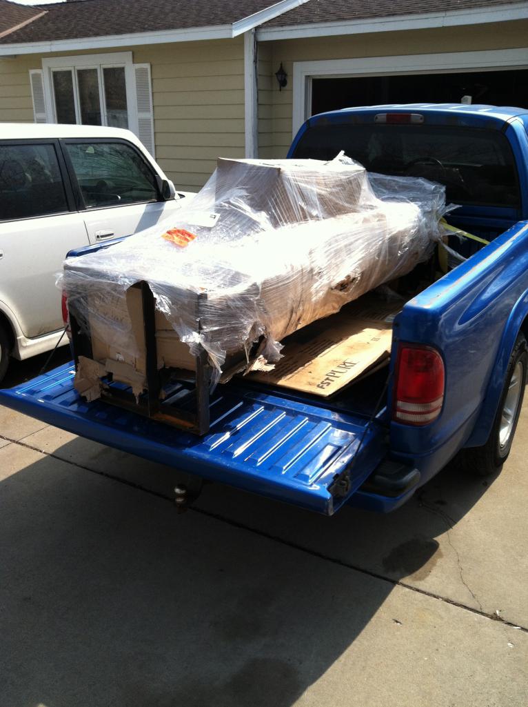

QUOTE(rhodyguy @ Aug 3 2014, 05:26 AM) *
Dannmar maxjax. $2299.99+shp and handling. that's a costco price.
I got it on sale for $2100.00 with free shipping. I picked it up at the local freight company and they put it in the back of my truck. I used a chain hoist back at home to lift it off the truck bed.
