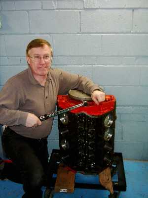

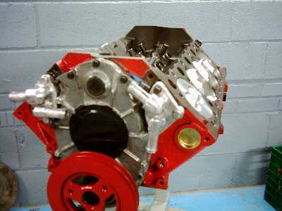

Engine is going to be a Chevy Camaro LT1 (1995) 350 cu.in. with aluminum heads, and
other light weight components. The engine was dismantled before Christmas and sent
off to the automotive machine shop for necessary work I required, while I purchased
the new rebuild parts from my supplier friend in Halifax, NS. (wholesale purchase of
course) Got the engine pieces all back from the machine shop about two weeks ago
and thus have slowly started the rebuild assembly process. According to my engine
guy, with a little work on the heads, pistons, etc. it should make about 375 HP with 350
ft.lbs of torque. Hopefully it will perform nicely in a 2400 lbs. Porsche ! Check out the
attached photo of partially completed short block with yours truly !

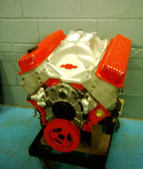

Greetings to INTERESTED V-8 teeners; Progress today and another photo
Bondo, the water issue for me has always been to use the RSH conversion externally
mounted water pump the same as most other conversions. So in order to do that I
needed to fabricate special LT1 type water adapters as sent on the front of my engine
below. These didn’t get welded at the correct angles I wanted but they will work fine.
Because the LT1 is reverse flow cooling (water flows through the heads 1st. then down
through the engine block) I wanted to make sure I was addressing this properly, at
least in my own mind. The two OUTPUTS from the External water pump will run across
the top of the block and connect to the top two fittings Block INPUTS, while the bottom
two Block OUTOUTS will connect into a remote thermostat housing, to be located near
the top of the block with a mounting adapter. The OUPUT from the thermostat housing
is about 1.25” diameter and this will then be reduced and run back to the radiator. All
the fittings are made to accept 0.75” water hose. One major modification being done
today is to the actual External Water pump, because the older style RSH pump has a
small opening which in turn is half restricted further when the threaded elbow is
inserted into the water pump. My solution was to locate a standard GM thermostat
housing and then have my friend at their machine shop, do the following: cut the inlet
to about 1.25”, mill it flat, then drill, countersink and tap bolts into the rear housing of
the water pump, then the GM thermostat can be bolted to the back of the water pump
and no restriction. There are some other modifications or changes that may follow if I
believe or find any restrictions to overall cooling system. Another reason behind using
the above setup also revolved around the idea that since I am using aluminum cylinder
heads/intake manifold that my engine should run cooler than many other 914
conversion. (If not I will drive it on cold days like yesterday with - 5 F. or a 75 F
summer day)

For anyone considering V8 conversion, DON’T use an LT1 if you can get another Engine
like an LS1, or an earlier SBC before 1991. There are many reasons, but the main one I
learned earlier today from GM dealer was that the LT1 was a limited build by GM for
only six years and they replaced it with the LS1. Parts already are becoming hard to
find especially the smaller minor type parts. For all those wondering minds, WHY did I
choose the LT1 ? really simple, I had thought it was similar to most all the earliest 350’s
and it is in many ways, but in other ways it is unique, especially with regards to the
Opti-Spark, timing cover and front Gear driven water pump ! A close observation of the
timing cover may reveal a massage with my die grinder to get the cover to clear the
water adapters and balancer when properly assembled. For now just position for a
photo shoot. But I got a great deal on this used engine with Aluminum heads and
thought I couldn’t pass up this deal. Only to learn later that it needed a complete
rebuild because a bearing had turned on a connecting rod and also damaged the crank,
which is the reason I have replaced a few key items and prepared for a complete
rebuild. Thus after getting everything back from the engine shop I have begun not only
my V8 conversion but the engine rebuild assembly.

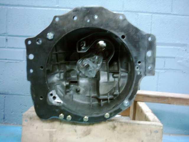

Things are moving along slowly as I have decided to make some changes and try to improve upon some of the older RSH components and methods of actually completing the conversion. The LT1 long block is completed and just need to handle the carb and distributor along with some minor items.
The tranny (Audi type) is being considered and thus needed to fabricate my own adapter plate, along with tranny mounts, shifter, clutch linkage, etc. This is also moving along fine, with a few challenges. I now actually have my 914 in the driveway which will shortly be finding it's way into the garage and begin the process of preparation for the LT1 installation. Will also be installing and beefing up the trailing arms, and some suspension mounting areas and possbile seam welding additional areas as maybe considered necessary. Have already given serious consideration to colling systems and planning to use a similar system to the Jaidecar with the inlet for the radiator at the front and the outlet in the "Bottom of the front trunk" ANY COMMENTS or thoughts on this being a good method or reasons why not would be greatly appreciated.
Well that about covers it for now and will provide additional info and photos of the progress. All the best
Allan

Progress report; had some trouble adding the photos so I will try again
See Below
Allan
ajracer
post Feb 20 2005, 08:44 PM
Posts: 204
Joined: 18-April 04
From: Toronto, Canada
Member No.: 1,945
Photos # 2 showing the custom adapter plate

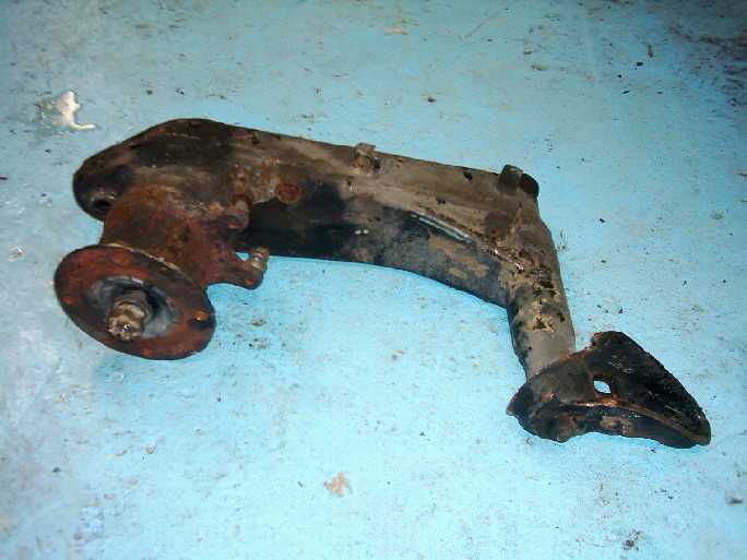

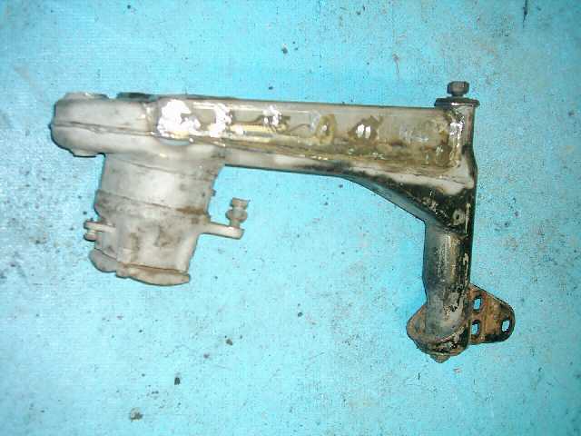

Started yesterday on the rear suspension and specifically working on the broken
control arm mount bolt; which was removed with an extractor along with some
persuation with my torch. Also got sandblast the control arms and weld in the
re-inforcement kit, after grinding the welds I moved on to cleaning degreasing and
preparation for painting soon. Slow process but also rewarding in seeing actual
progress. Photos attached for reference only.
Allan
ajracer
post Feb 27 2005, 02:05 PM
Posts: 204
Joined: 18-April 04
Member No.: 1,945
Another Photo after installing the re-inforcement
