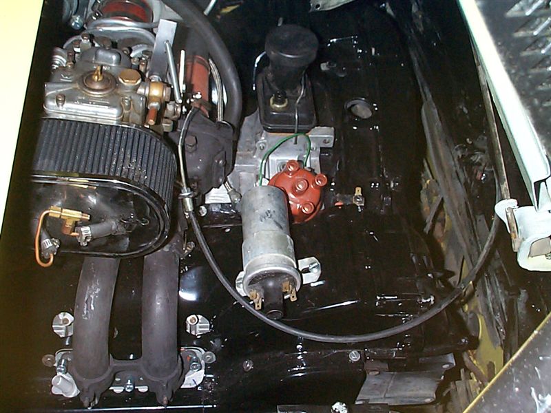

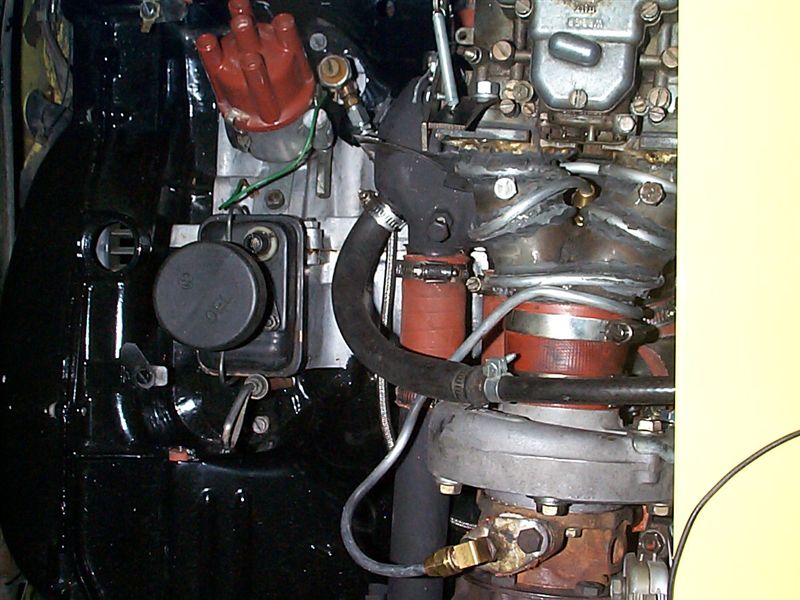

1bad914
post Jan 24 2005, 01:03 PM
Posts: 618
Joined: 6-May 04
From: Battle Creek, MI
Member No.: 2,028
If you re-read my post it says dual carbs, I'll be using single DCOE 45 weber, Garret T-4 pushing 11-12 lbs of boost. I had it running before, but thought I had a bad turbo, but realized it was some issues with oil return to the case after cooling the turbo! I'll get it right this time!
1bad914
post Jan 24 2005, 01:06 PM
Posts: 618
Joined: 6-May 04
Member No.: 2,028
Another
Mueller
post Jan 24 2005, 01:13 PM
914 Freak!
Posts: 17,155
Joined: 4-January 03
From: Antioch, CA
Member No.: 87
nice.......as old skool as those draw-thur setups are, they sure as heck work and put down some serious power (IMG:http://www.914world.com/bbs2/html/emoticons/smile.gif)
hurry up and get it working again...we want to see some "numbers" (IMG:http://www.914world.com/bbs2/html/emoticons/biggrin.gif)
