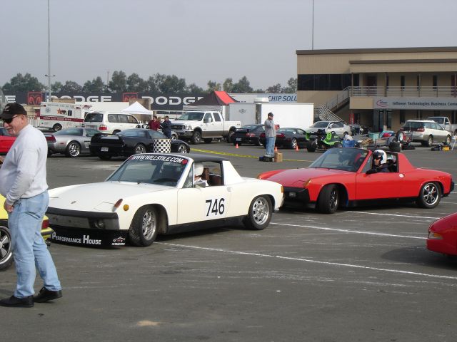

Here's a couple a low ones.
First thing I did on both my cars was slam them way down.
Gravel pusher... (IMG:http://www.914world.com/bbs2/html/emoticons/cool.gif)
They do handle a ton better and I think they look better , too.
I have adjustable rear spring perches so it isn't raked as steep.
After the bump steer kit, turbo tie rods and alignment were done. Wowie wow wow, wow! Look out! (IMG:http://www.914world.com/bbs2/html/emoticons/boldblue.gif)
If you don't get the alignment or other items you won't really hurt anything*. Tires may wear funny ( rotate them ).
The extras I mention help you to realize the potential handling this car can offer.
KT
* I ran most of the a/x season and street driving with it lowered only. Only stepped up for the last few events.
