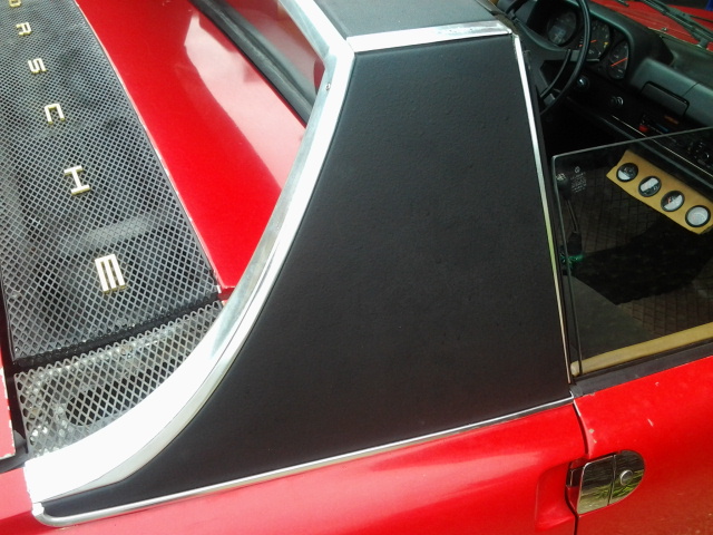

Ok check this out. I think I have seen where other folks have painted the sail vs. using the vinyl. Here is my attempt.
I have purchased (from 914Rubber.com) the sail vinyl, but my car is so far from needing PRETTY anything, I thought I would come up with a pre-PRETTY alternative. I have used this paint on the BLACK Long covers and it looks pretty good. Has held up for about 5000 miles so far.
Dupi-Color Truck bed liner. Thick, Textured and seems to take a beating. Once it is time to make the car pretty by painting it, I can sand it off and install the 914Rubber version.
what do you think?
I painted the final coat on this one last night. looks like some thick spots are a bit darker, the color should even out. It did on the longs.

Not bad. Especially for a driver. Do they make it in a brushed aluminum color?

QUOTE(boxsterfan @ Sep 10 2014, 09:48 PM) *
They have a couple of products for bed liners, all I see is black. But I did see a Trunk Spatter product in a lighter color. Check out their website....

Looks good.
I used Rust-Oleum's Hammered paint for the same effect.

That is pretty good! I installed the German 914 vinyl and it is very nice but I am not sure it is leaps and bounds above that.

That's what I used for my targa top. It has the texture already in it, and it's deigned to be durable and in the sun. I have not had any issues with it so far.

The texture looks a lot like the targa top's texture (IMG:style_emoticons/default/smile.gif)

OK, I have installed the chrome. From 10' maybe 15... (IMG:style_emoticons/default/piratenanner.gif) it looks like the real deal. Let's say it's good enough for me for sure. Just cost me a little time, masking tape and elbow grease to clean up the chrome.
