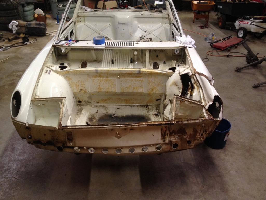

Now, since I promised I wouldn't spend any money on this restoration until I knew what I was in for, I've spent the last two weeks doing free things. I got the car down to just the body shell:
And completed what I hope is the WORST job about restoring a 914 - removing the tar mats and trim adhesive from the interior:

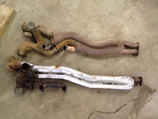

It's a '74, and I think a 1.7. The intake setup is a kind of goofy custom job, but the heat exchangers look relatively new. Will 1.7 heat exchangers work on a 2.0?

Yes they will fit but the restriction costs you some HP.
poorsche914
post Sep 16 2014, 08:15 AM
T4 Supercharged
Posts: 3,145
Joined: 28-May 09
From: Smoky Mountains
Member No.: 10,419
Are the heat exchangers stock or stainless steel?
If SS, then they work same as the 2.0 version and are no more or less restrictive.
They will bolt up fine to a 2.0 engine but you will also need to use the 1.7 muffler and mounting bar.

on the group buy thing they do come and go, i would get what you think you need the most. at times you will se something you know you will need and just cant pass up based on price. when i got my SS HE's i only pain $200! they were like new! but are the 1.7/1.8's - since i was ordering my muffler(triad) (i have a 2.0 motor) i was able to get a great deal on the H.E.'s and got the muffler and hanger that match it. The exhaust ports on the motors are all the same so you can put the 1.7-8 on a 2.0 just hve to match up the proper muffler and hanger - since mineis a 75 and those are horrible- they were leaking bad and rusted out, i tore those off and backdated to the 74 variety. much better IMHO. you mght be able to trade with someone if you want the 2.0's, but certainly can keep what you have.

Here's what the right-side heat exchangers from each car look like (parts car exchanger is the lower, shiny one):
I guess the big difference is the number of pipes to the muffler. The resto car had an original Dansk 'hotdog'.

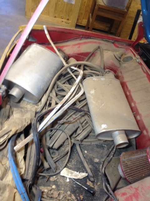

These two mufflers are in the trunk of the parts car (along with a bunch of other items I haven't sorted through):

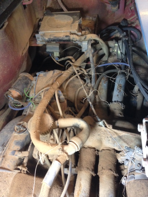

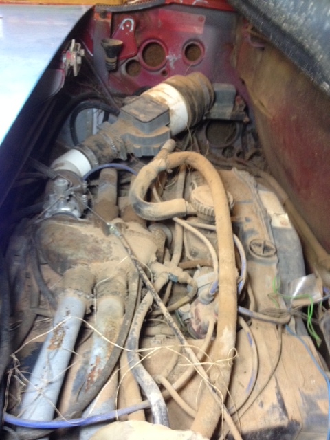

And here are a couple of the engine compartment on the parts car. I don't recognize the set-up here:
I don't think I'll have much need for heat or defrost since I'd tend to drive the car in pleasant weather, and I'm in the Texas Panhandle anyhow. I'm not sure I really have a need for nice heat exchangers, particularly if I'd wind up loosing horsepower. Thoughts?
